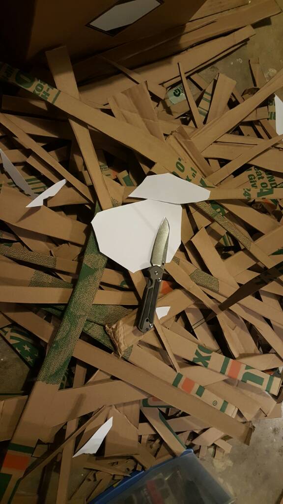

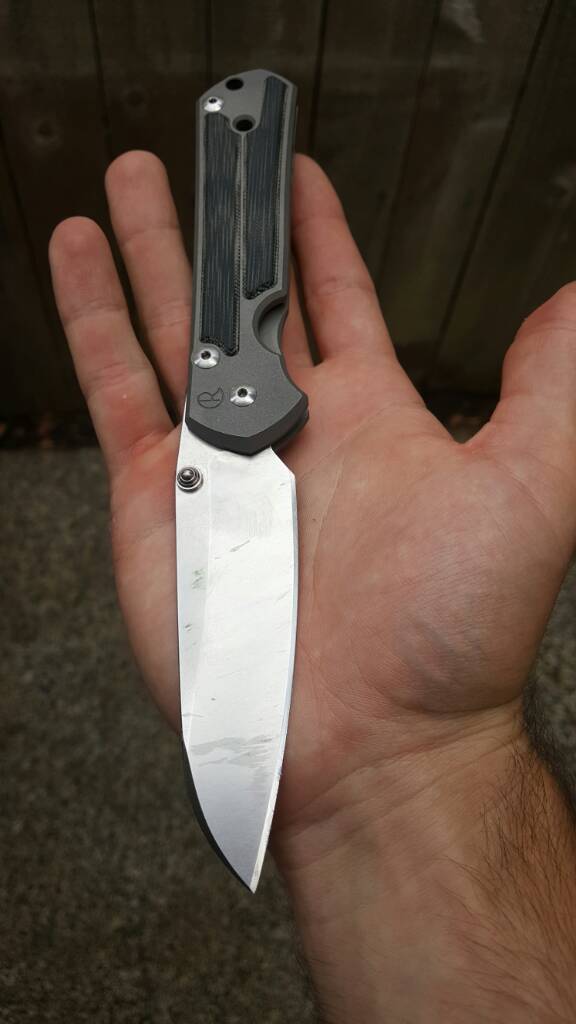

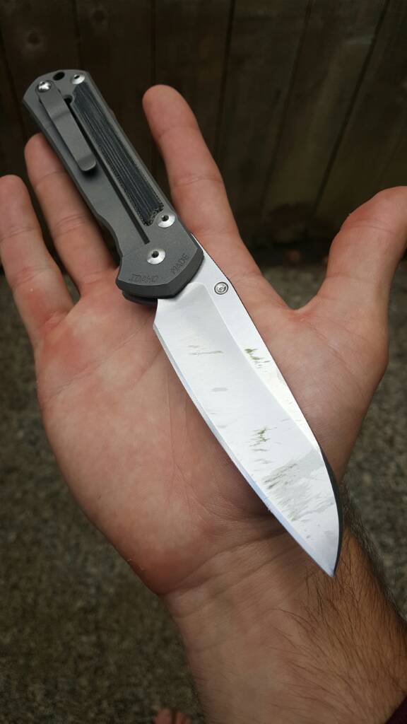

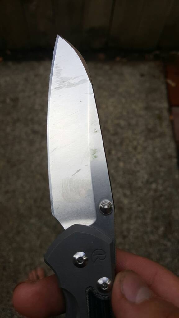

I recently moved and have several empty boxes left over so I decided to do a cut test.
I used the same box of cardboard (largest Uhaul box) and cut the same dorection in the cardboard for every cut.
I tested the sharpness on printer paper after every 300 inches of cardboard was cut.
Before I started, it could shave the hair on my arm.
I stopped cutting after 4,995 inches of cardboard had been cut, since I figured I was nowhere near finding the point where it would stop cutting like butter. The printer paper cut almost just as easy as when I first started and it would still shave the hair on my arm (with a bit more effort than at the start, but still shaved)
4,995 inches of cardboard and still super sharp. I estimate at least another 10,000, or so before it would start to show signs of dullness.
I have a 17° primary bevel, with a 25° micro bevel.
Very impressed with how well the blade performed. I know this info may be redundant but it was my attempt to try putting a sebenza through an indoor controlled test to see how well it would work.
If enough of you want me to, I can push this to the point where it will no longer shave arm hair or cut printer paper.
Let me know what y'all think!

Thats very impressive almost 5,000 inches of cardboard and still shaving sharp. Thats a pile of cardboard.
I'd be curious to how much cardboard it would cut before it's dull, but my guess would be double that 10,000 inches.

Blade steel is s35vn, HRC of 59-60 but if I had to guess for this one it would probably be on the higher end.

This was thick cardboard, harder than most cardboard. It was single walled but the walls are thicker than normal single walled cardboard. As far as being out lasted by other blades, I have owned lots of knives the last few years and I would agree with you on the old sebenza hardness being out performed. This one is of the newer batch, and I also added a sharper angle to the edge than factory. It seemed to come with between 22 and 25 degrees on each side. After I sharpened it to 17, with a micro of 25, it cut like butter through pretty much everything.
I am sure it could be out performed by other harder steels but with the new edge angle, and toughness of s35vn, plus the new hardness is a huge win. Perfect for if the edge hits metal on accident, and can cut like a laser.
Very cool post! I hope you do realize you cut over a football field of cardboard. That is a lot of cardboard:D!
Thanks! Haha I didn't even think of that, pretty crazy.
