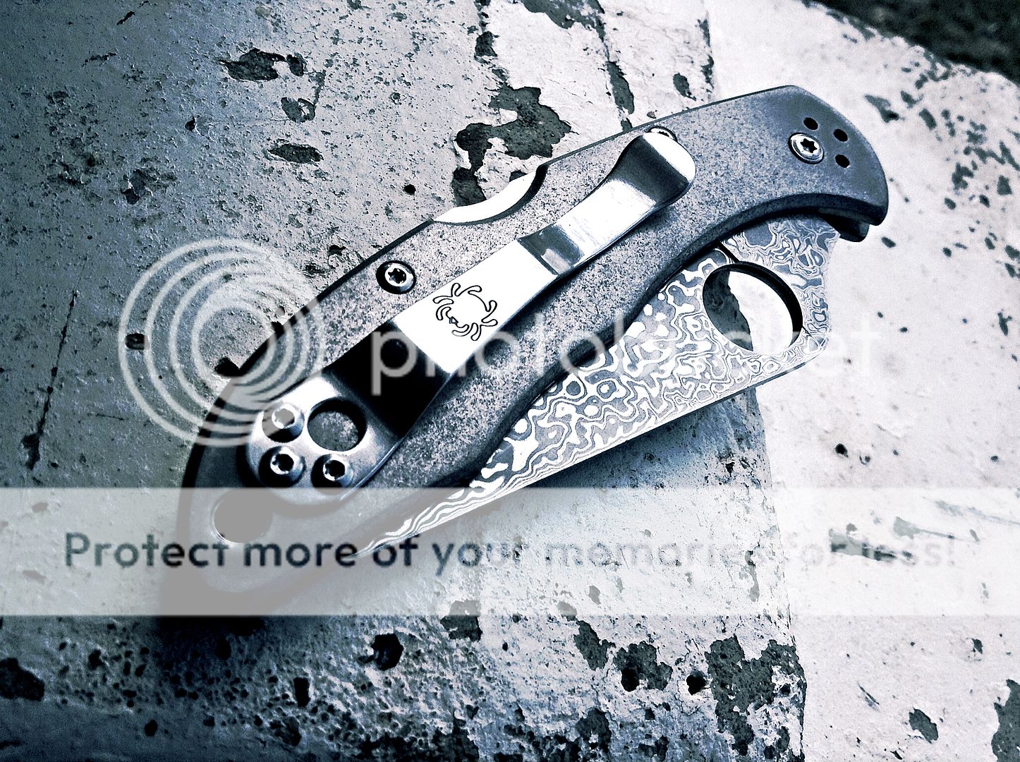

harronek harronek How did you get that finnish on the Ti and the SS clip?
It is a stonewash finish that I did myself with a screw top plastic jar , gravel from my driveway , WD40 and my wifes clothes dryer .
It is one of the better mods I've done , and one that I highly recommend to anyone that uses their Ti-Damascus
The standard Ti-Damascus scales are polished and the second you start using and carrying the knife they scratch and look horrible ( to my eye the scratches look horrible because they are scratches and not the snail trail type marks that you get with stonewashed or blasted Ti ) .
Maybe Spyderco designed them to be show ponies and the real work should be done by the FRN Delicas .
I originally didnt stonewash the clip but after stonewashing a few of my factory black painted clips for my FRN knives I put a washed one on the Ti - Dam and really like the subdued look .

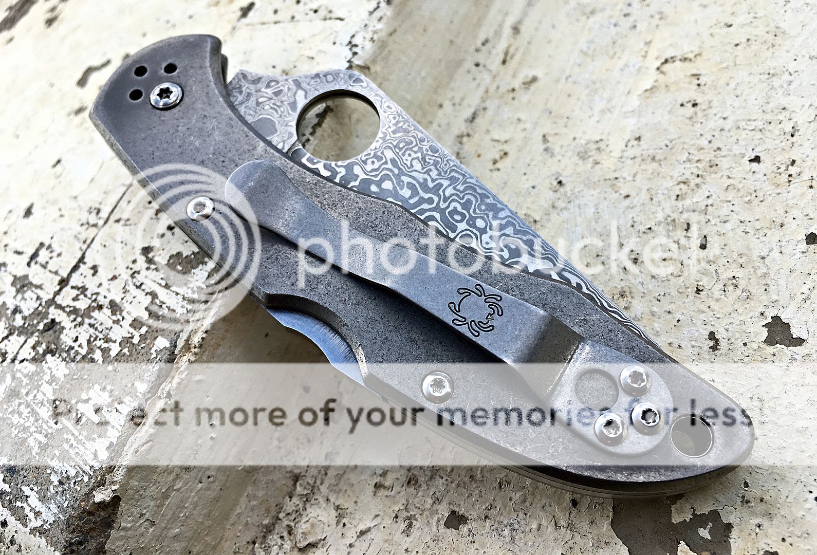

Here is a pic when it had the standard polished clip .
