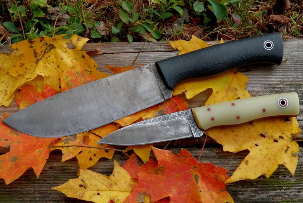

The Camp Knife in these photos, is my favorite large knife ever. It's 3/16 O-1 with a full height grind, and a tapered tang.
This is how it looked when I got it.
This is how it looks after quite a bit of use from myself, my partner and assistant, AND being thrown into the fray during a bushcraft challenge at Ethan Becker's spring gathering, THEN passed around again at Ethan's autumn gathering. Trust me, you DO NOT want to pass a knife around in this particular group of people unless you have faith in the knife being solidly built. Other than looking like it has been used now, the Camp is no worse for the wear.
The great thing about 01 is how tough it is. Thats why we do that knife in 5/32 as well. Have we had to fix one? One? No. They've had tapered tangs.
