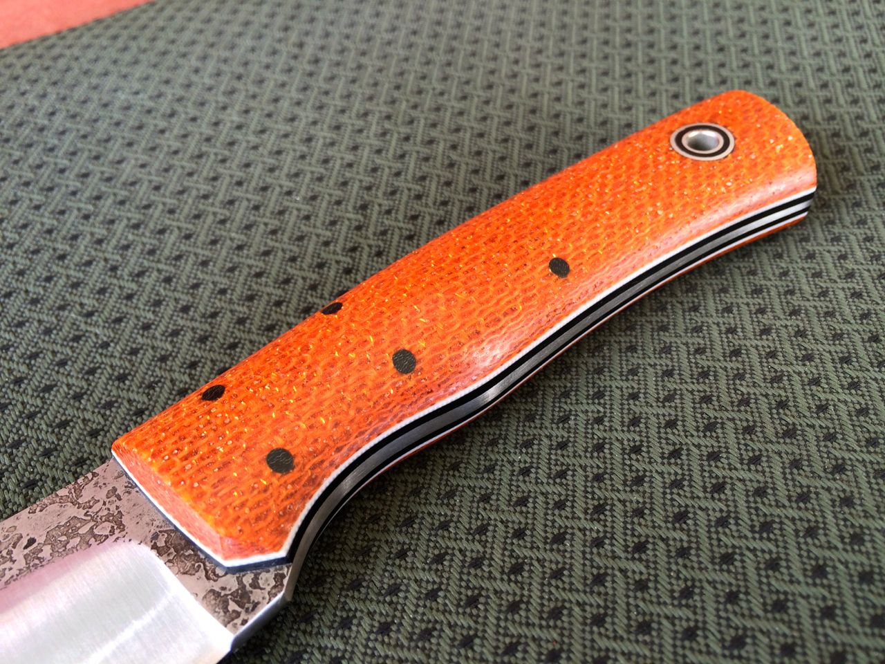

I love your 'electric Orange' stuff. I'd like to see a few others with the same kind of 'vividness' that those have. Almost neon in coloring. They age beautifully too
We did two "electrics" an orange and a green. We sent a half sheet of each to Andy. He used it but did not order more. It is a "premium" burlap with 2% metallic threads woven in. We can get it in a red also.
My Camp Nessie is one with Electric Orange with the metallic thread. I think it's pretty cool. I don't think any of my pics of it show off the thread very well. I'll try to get a better shot of it.
