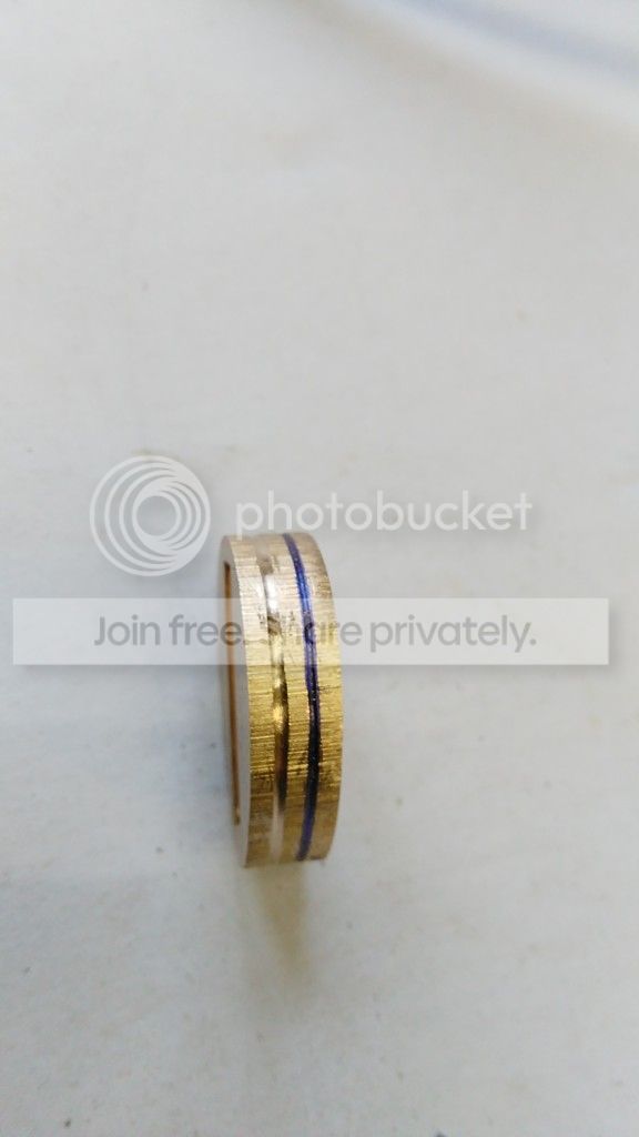

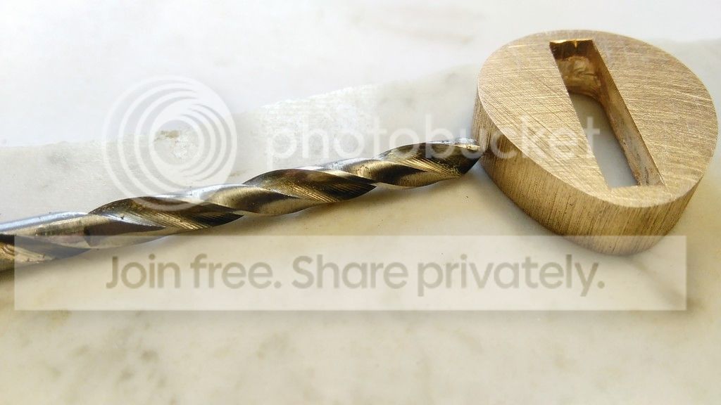

This is 6mm thick bronce (less then 1/4"thick)
Just patience, 2mm round needle file and sandpaper around a 1,5mm thick drill bit and more patience
Handsand the deeps to 2500 and the highs to 800

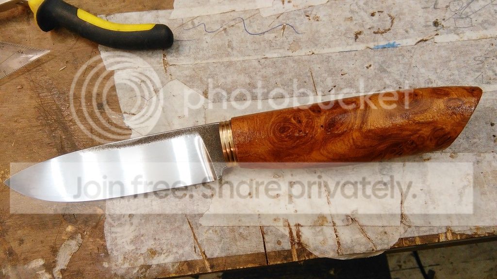

Having finished the knife, I thought I'd close out this thread with some photos and a video. What worked best for me was a 1/4" single-cut ball burr in my Dremel. I built an aluminum table for the Dremel router attachment that worked fairly well. It required special (dainty)care when removing material near leading corners on the workpiece... but I'm happy with the results.
Thanks for your help on this.
Erin
That Certainly came out nice and the flutes are very distinctive...:thumbsup:
