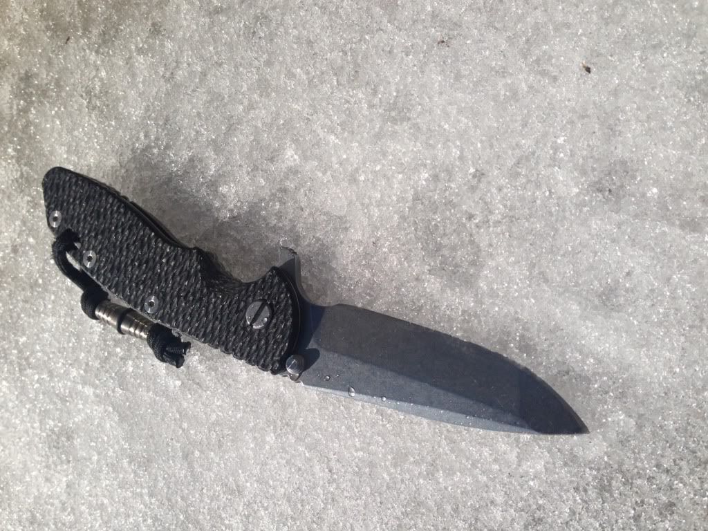

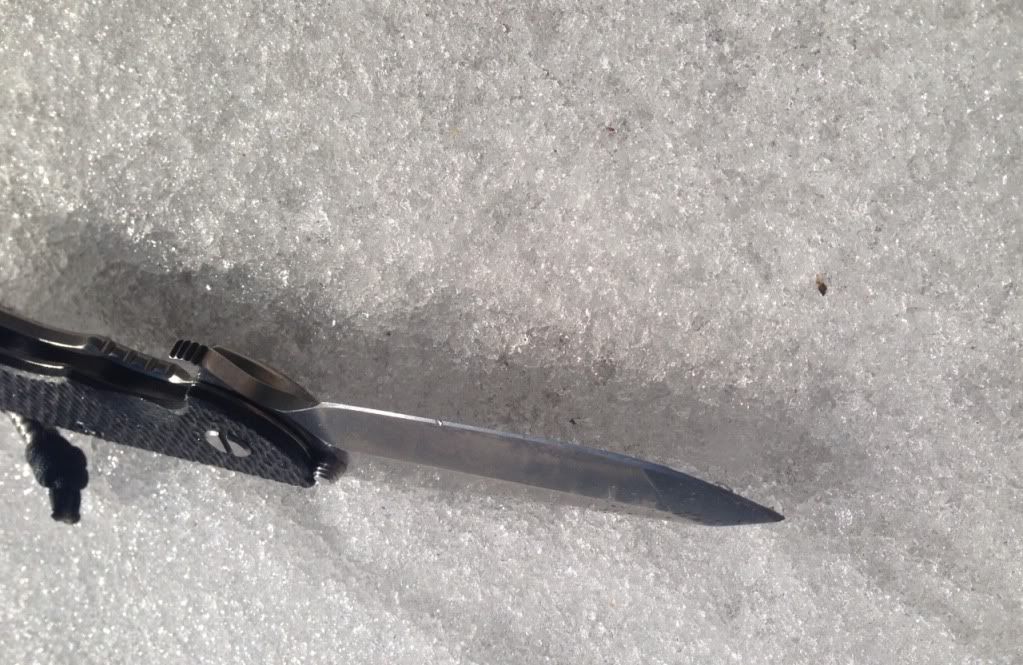

Recently touched this one up on the WEPS to 600 and a few passes on a steel, bottom of a coffee cup...whatever was handy....so I'll throw up a couple pics since this threads asking for them...
Images not too fancy (my usual)...
