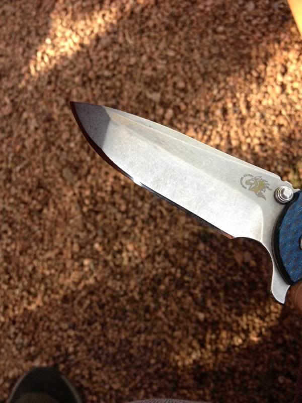

Sharpened your Hinderer? Let's see the edge...

Thanks. :) Went from 400 to 2000 grit then stropped on leather loaded with cheap chromium (II) oxide compound.
^ sweet. Now you got me wanting a mirror edge. I'm going to put one on my slicer today. :) nice pics by the way!
Ok fellas...I'd like to know. Is the mirror worth the effort? I never have polished an XM's cutting edge (in any steel) to a mirror and find they take and hold an edge nicely. Benefits of the beautiful mirrored edge?
The actual mirror edge- purely an aesthetic.
The process of "mirroring" the edge - Hobby.
IMO
^ I agree. I've done it many times myself. No benefit other than aesthetics. I actually prefer a "toothy" edge on my hinderers.
I find that mirror cuts smoother and cleaner compared to a low grit finish, then again that's my personal preference. Low grit for aggressive slicing, polished for push cutting.
