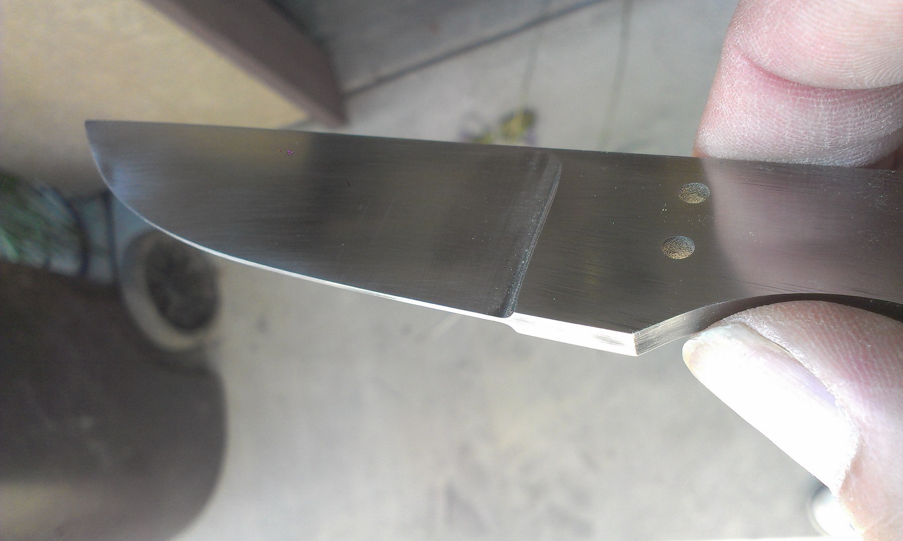

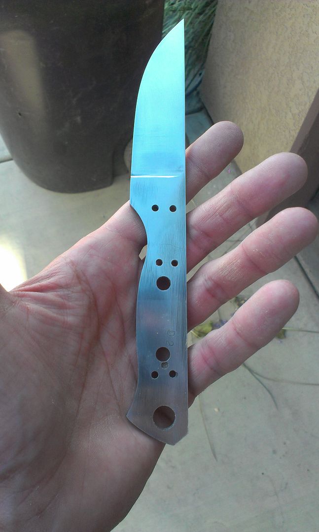

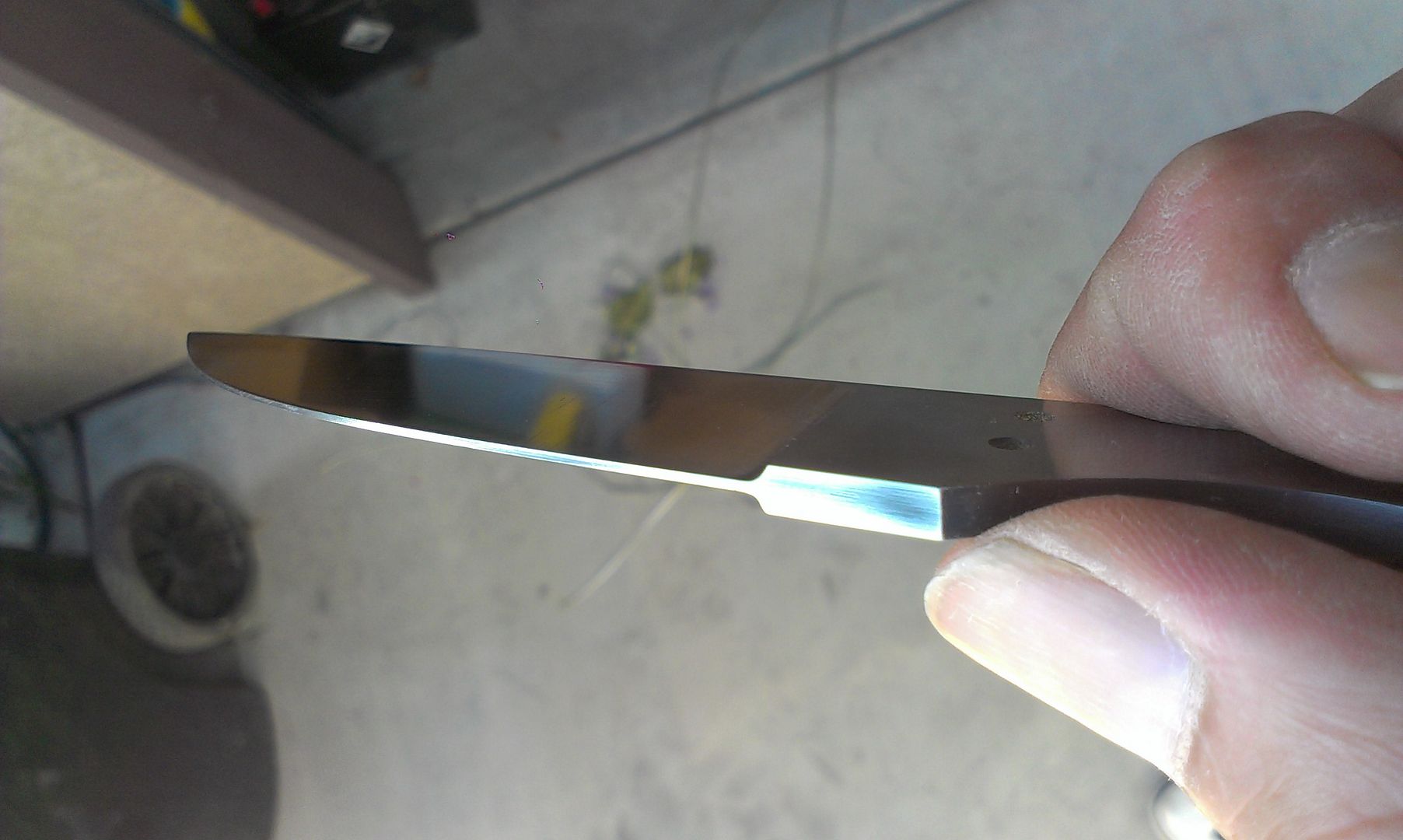

Here are some pics of the edge. As you can see, it's not only the edge, but how it runs into the ricosso that is a problem.

Seems like that would make for an awfully nasty bevel, but I could be wrong. My goal is a good looking edge, but who really knows what I'll end up with.
I'm still thinking about cutting a small sharpening choil. I just can't get past how the edge just keeps going into the handle. It's not only ugly, but doesn't seem like it will be very workable. Maybe a small dremel bit, I'll have to see what I have.
I start edges like that on a belt sander, sometimes I'll even finish on one but it's tricky when you don't have a variable speed. The delta 1x30 works fine and I'd start that edge off using a fresh 120 grit belt, just keep the edge moving and be really careful near the tip so you don't overheat it. It doesn't need to be perfect, it just needs to reduce the work you have to do by hand to finish the edge. To keep things even by hand just sharpen a few hundred strokes on one side and then flip and repeat using the coarsest/fastest cutting stone you have. Once you start getting near the apex reduce the number of strokes per side until you get into genuine sharpening territory.
I would not care to tackle any actual stock-removal/reprofiling work on hardened tool steel without the benefit of electricity.
I start my edges post-HT with an A45 or A65 belt at moderate to high speed. Use the same number of light passes on each side, until it just starts to reach an apex and begin to cut. It takes literally seconds.
.020" at the initial edge is awfully thick for a blade that size. I would very much recommend continuing to grind the bevels (following the current geometry) until the edge thickness is more like .015" or even .010" if you really want it to cut well.
Who ground the blade to begin with? Most makers and manu's leave extra "meat" before HT to help reduce/prevent warpage, and finish-grind afterwards. Many don't grind the bevels at all before HT.
