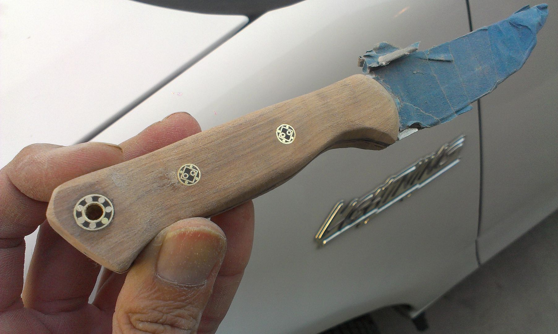

I've done a lot of work, it's all epoxied and the pins/tube have had the preliminary grinding and clocking, but there is still many hours left before I'm done! :)
The knife as of today.
Blunt, I started working on the blade with an 80 grit belt strapped down to a bar of 1095 that I had laying around. D2 is some serious stuff but I'm making (slow) progress.
Thanks for the advice!

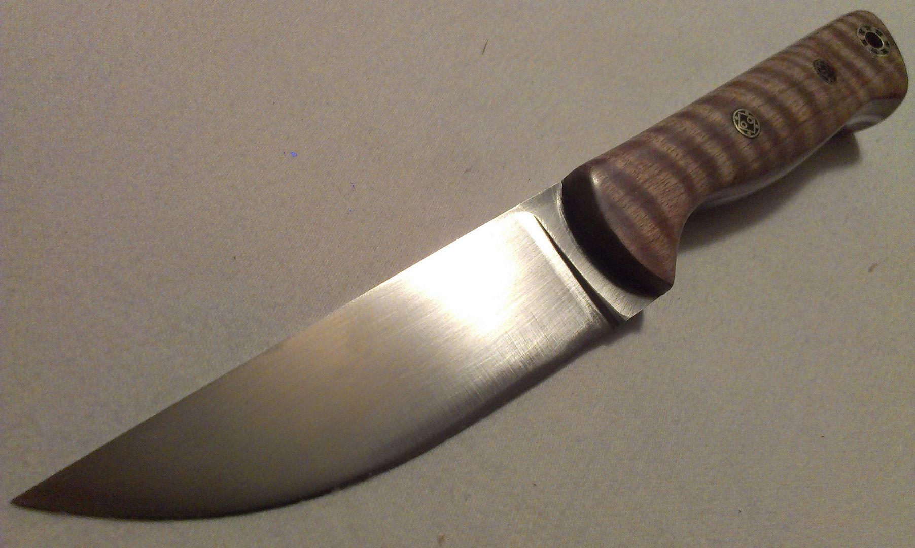

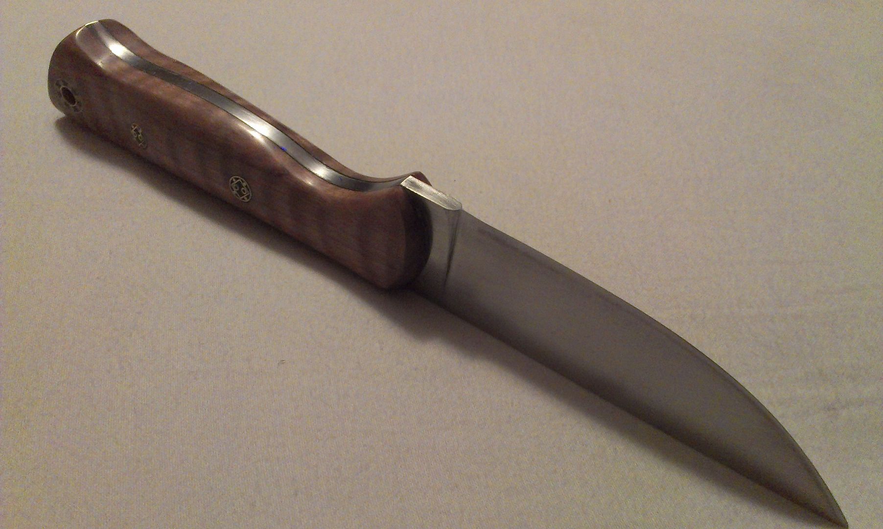

Just wanted to update.
So if you added up the hours that I spent on this knife start to finish, and applied what I normally get payed for an hours work...
Well, let's not do that. :D
In the end I spent a few hours grinding the blade until I got an edge about the width of a dime, less in the belly and toward the tip.
After much consideration I decided to use the belt grinder. I got a nice convex edge that I finished up last night by hand.

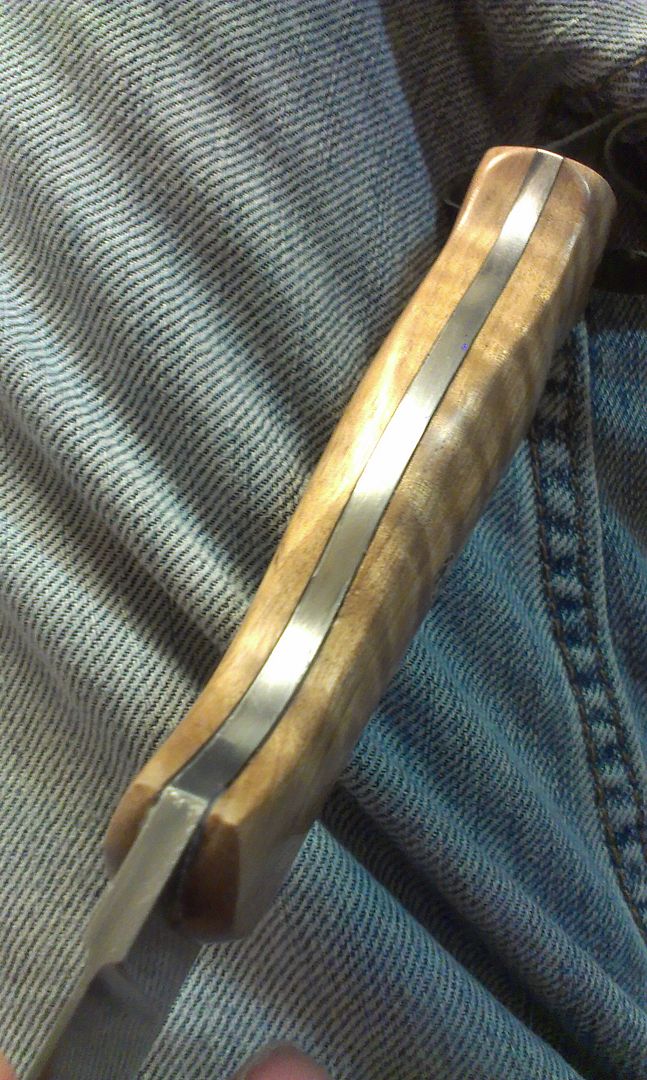

I can't really show the edge very well. I'm more proud of the handle though. I wish everyone could feel it. It's comfy! :)

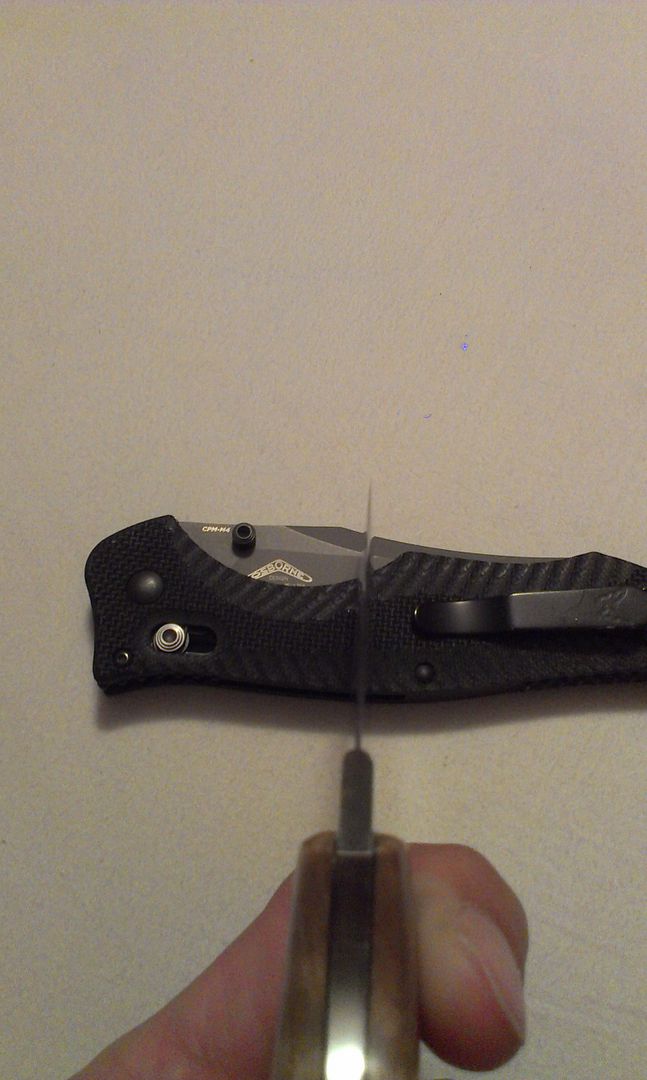

Poor attempt to show the edge... (810 is just there to help the camera focus)
Thanks for your help guys!
