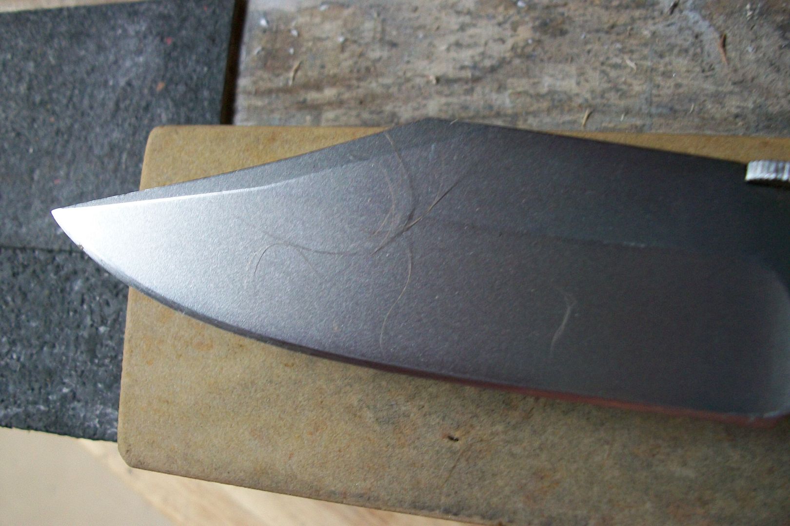

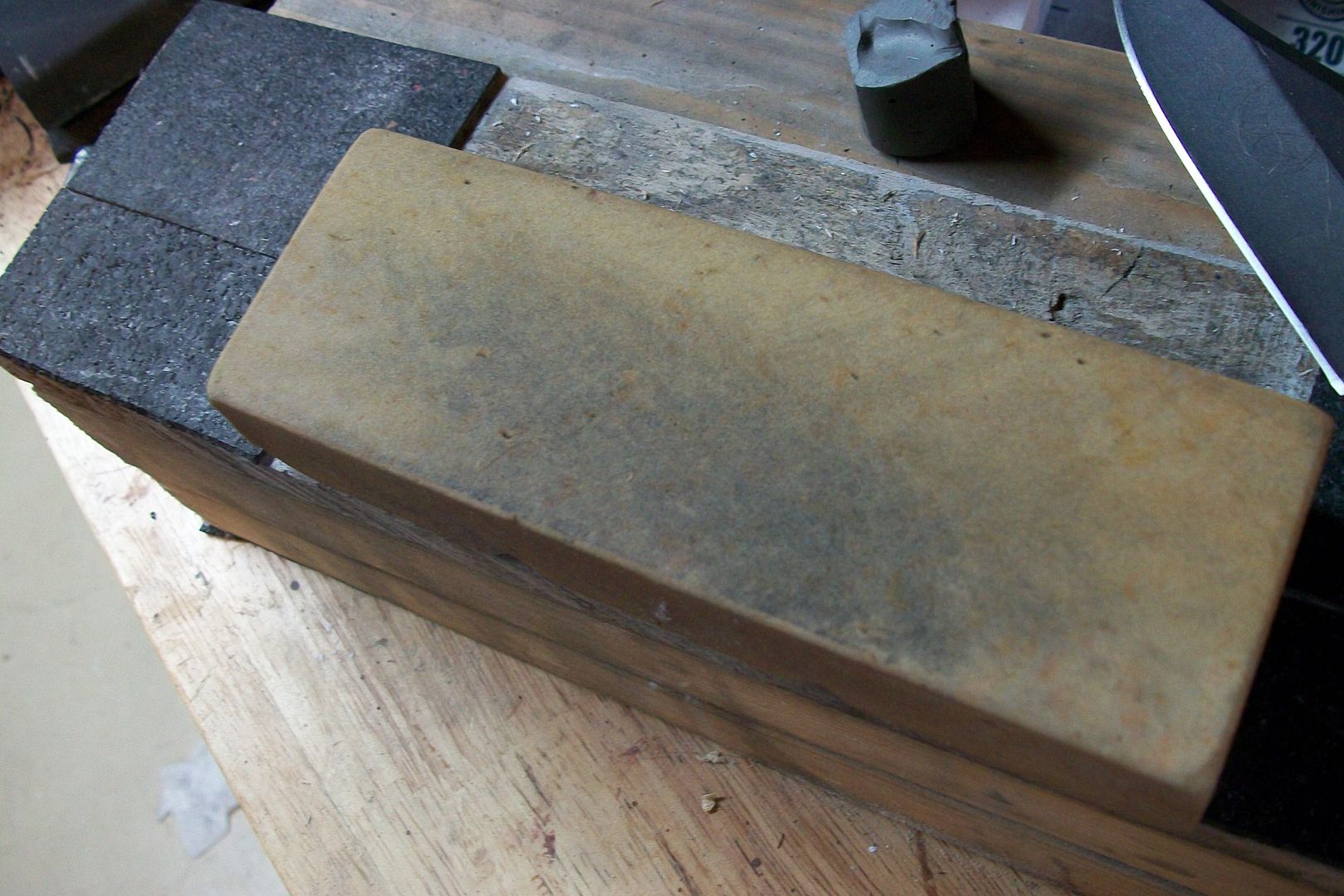

Is not 440a, but 440c, one of the earlier CS Recon 1, still no picnic on Arkansas. I ran the edge across a few times before starting to remove the previous apex. The existing edge had good geometry and could just scrape off arm hairs. Thin film of oil on my old Softie and off to work. Is a real good example of the class and one of the first nicer stones I bought myself probably over twenty years ago. Felt good to take it out again, that old familiar scent of the cedar box.
Couldn't treetop arm hairs (my arm hair is mighty thin) but was able to clip a number of leg hairs 1/4" above the skin - two or three per pass of various length - so not "with authority", but not a fluke.
Edge appeared to be burr free at 20x, couldn't say for sure without doing some paper stropping or other testing that would have DQ'd it as being "right off the stone". Am pretty confident it would pass even closer inspection.
Raised burr, elevated just a tad for a few passes to eliminate, and then a number of light alternating passes at original angle.
That actually looks like a great quality stone.

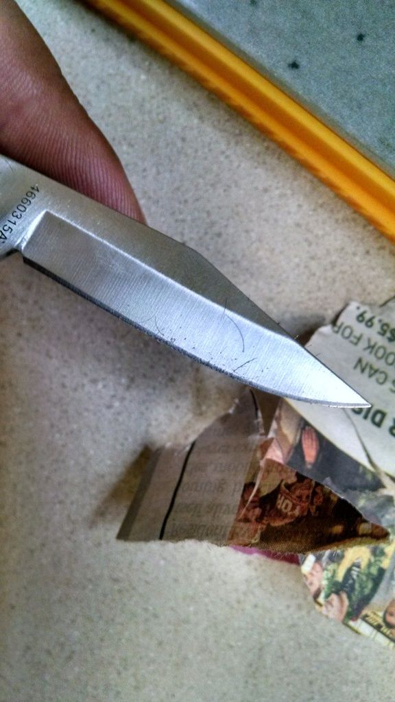

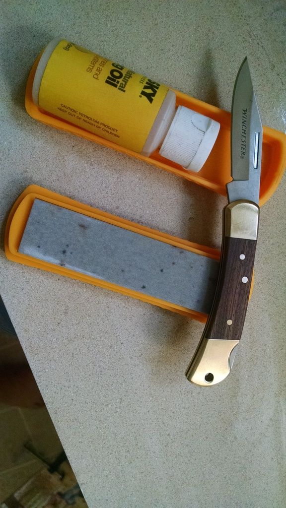

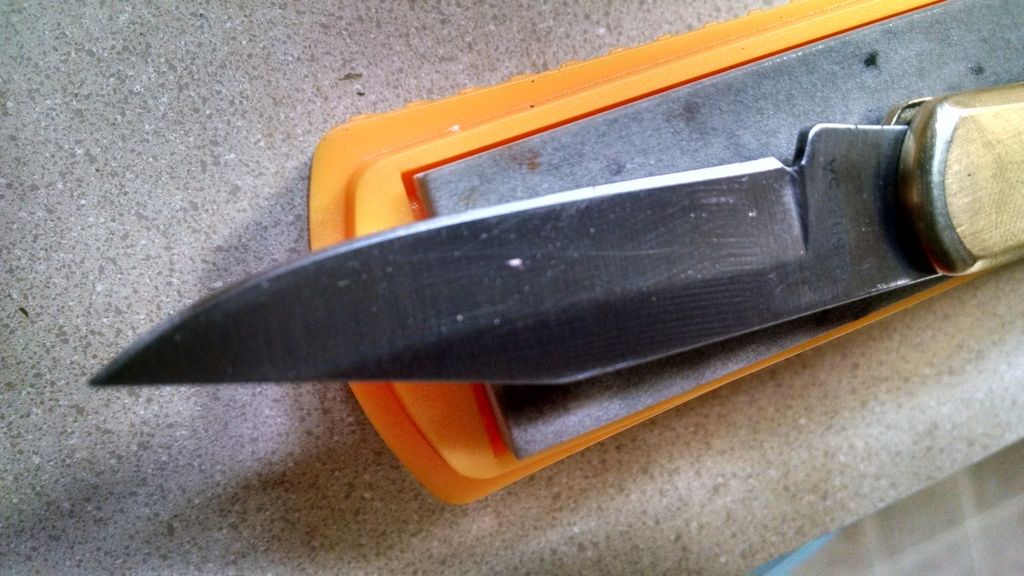

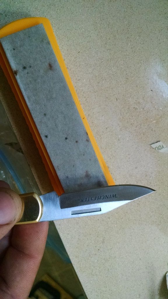

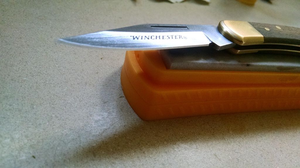

Finally bought the stuff for the challenge.
$20 later,Here are my materials.
The knife is sharp enough to arm hair shave with out of the box.
It will cut newspaper but not great.
I attempted some very light edge leading strokes alternating each side. After several minutes I can pop the hairs but no treetoping.
After, I tried some light alternating edge trailing strokes, no improvement.
Think Ill hit it again tomorrow and re apex the edge.
I'll keep at it and post any improvements. Advice is welcome

Martin, your Arkansas stone looks like a Washita and Hero's a soft Arkansas. ? Just me. DM
David, the box it came in was stamped
Soft Arkansas
B & G Abrasives
It may very well be in the range of a Washita. I've had these for a long time by my standards - close to 20 yrs.
