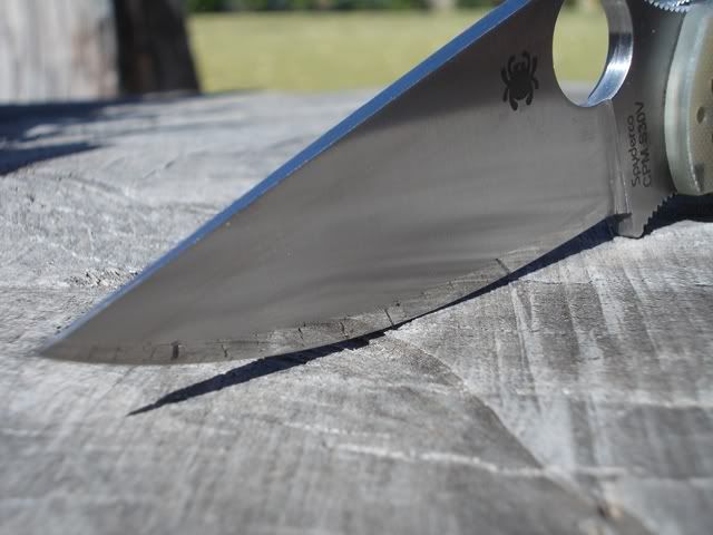

As an extreme example and not recommended for everyone. Here is my PM2 with an almost zero edge that I microbevel at 15 degrees per side on the Sharpmaker. You cannot even see the micro bevel in this picture. It has been reground (primary) and reshaped to an extremely low angle (the angle you actually see in the picture).
The issue with this is though at 5-7 degrees per side on S30V one needs to be careful for micro-chipping of the edge when cutting dirty material.
Maintenance on this edge (on a coarse stone) is however a breeze as any angle slightly higher than the thinned out portion easily creates a new crisp edge.

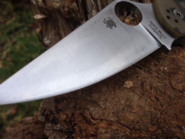

Here was the edge when I reshaped the edge to a lower angle and mirror finish.

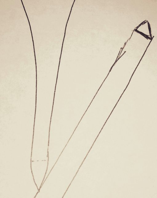

Question. Since the sebenza comes "convex" from factory, would I have to use both angles on my sharpmaker to get the knife to perform and be a proper edge? I'd imagine not, but I'm not a blade geometry scientist.
My first real sharpening of a factory edge is more of a rebeveling. I use the convex factory edge for as long as it lasts with stropping and touch ups, but then that first sharpening puts a conventinal "flat bevel" on the blade and that's the end of that. :D
I would say that it is not necessary to use the 30 degree setting on the SM unless you intend to reprofile. My theory is that by sticking with the 40 degree side, only the very edge of the bevel is getting sharpened. IMO, this is one of the benefits of a convex edge or a micro-bevel. The amount of metal removed is minimal and maintenance only takes a minute if it is done when it is needed (keep your knife sharp).
In my amateur drawing below, you can see that the SM rod only contacts the very edge of the bevel. If the rod was on the 30 degree side, you would see it contacting the belly and the edge would go untouched. Yes, with enough sharpening/maintenance, a reprofile will be needed, but that takes some time.
