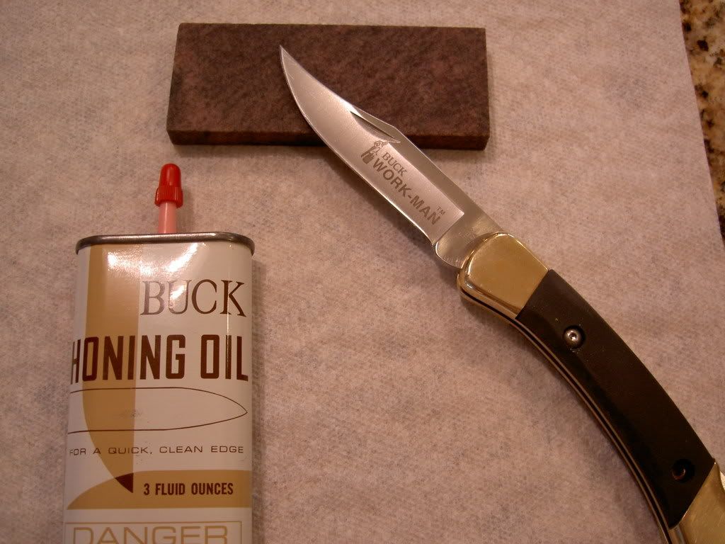

Well here's some pic's of the stones.....you figure what the Mrs. told me;)

Love that ole wet stone picture, I remember a neighbor that had one of those.

I had posted this a while back, I do use a diamond rod for a quick field sharpening, for all other work I use this... and it will sharpen s30v steel. This set came with a fine washita stone, that I use when I want a killer edge (so to speak ;)
(picture of Dave's old rubber bucky, too :)

man every time i see picts of one of thoes i kick my self fo it not looking better
got a new one i am working on..
