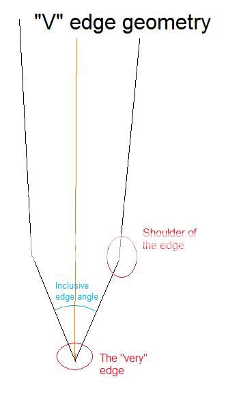

I just joined these forums and I recently acquired a Spyderco Paramilitary 2, my first edc, and I had a few questions regarding sharpening. I'm a bit puzzled about the term inclusive. I've ordered a sharpmaker along with the knife and I'm not sure whether I should sharpen on the 40 or 30 degrees placements. I do know that the angle of the knife needs to be lower than the angle you sharpen at, but I have no idea what angle of the factory edge of the Paramilitary 2 is. Moreover, for clarification I do not have the means to re-profile the edge nor do I have a way to measure what angle the blade is at.

Inclusive is just the total angle. Sometimes people give an angle from the centerline so the inclusive angle would be 2x that angle. Each knife is hand sharpened so can vary slightly but Spyderco shoots for 30 deg. The best way to figure out what setting to use is the sharpie trick. Take a marker and color the very edge on both sides. Take a couple swipes on each side of blade to see where you are removing material. If on the very edge, use that setting. If on the shoulders then go to the more obtuse 40 deg setting. If you touch it up frequently and don't let it get dull, the sharpmaker is a great tool. If sharpening a dull knife, it can take awhile because its not very aggressive.
What do you mean by the very edge and the shoulders? Because spyderco aims for around a 30 degree edge, should I just sharpen at 40 degrees? I also have a strop. I'm aiming for a hair-whittling edge

Its fine, I just got into edc's and I'm trying to learn more about sharpening before I actually attempt to sharpen my knife. I hear a lot of great things about the sharpmaker, I just want to make sure when I do use it, I use it right. If possible can anyone link me a video on utilizing the sharpie method for a knife? I'm still quite puzzled on how it works
May I suggest you practice (both using the sharpmaker, and the sharpie method) on a cheap kitchen knife?
The sharpie "method" is actually pretty simple; just color the edge with the marker on one side, then proceed to sharpen this side (2-3 passes). Examine the edge: where is the color gone? Where do you see exposed metal? That's where you removed metal from your blade. If it's on the shoulder, re-color, and 2-3 passes at a more obtuse angle. Examine the edge. Use very light pressure. Take your time. Open a cold one. Feel the burr :D

You can use the 30 degree, yes, but if the factory edge is more obtuse than 30degrees, it could take you awhile to reprofile to 30 degrees with the basic sharpmaker setup. You will have to remove more steel if that is the case. Definitely watch the DVD. IT's a nice little primer, so to speak, about sharpening in general.
what is the bevel? Right now my main concern is whether I will need to reprofile the edge of the PM2 prior to using the sharpmaker. Right now I won't be able to get the diamond rods, but its something I'll look into later. Thanks for the advice though
the bevel is just the angle of the edge.
A few more questions. What is the micro bevel and how would I reprofile my edge to 40 inclusive?
If you had an edge that was a 30 degree inclusive angle and sharpened it with the 40 degree angle, that would give you a micro bevel. The first thing you need to do is determine what the edge angle is at right now, approximately, using the sharpie method.
The microbevel is like another tiny edge on top of the already existing edge. It would be pretty time consuming to reprofile a knife to 40 degrees inclusive with the sharpmaker. If you are good at freehand sharpening, you could use a stone. ore you could go with a guided sharpening system such the lansky as a cheaper one or an Edge pro or Wicked edge for the more expensive ones.
