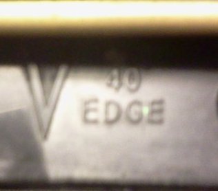

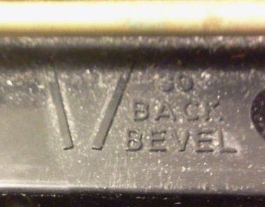

40* is not the back bevel angle. 30* is. Here it is straight from the device itself:
I haven't watched the dvd, but probably what Sal said is Spydercos come at 30*, so you can skip doing the back bevel since it's already at that angle (30*) and jump right to the microbevel/edge at 40*.
