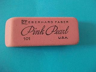

After the heavy cleaning and in subsequent use after the fact, use a pink pencil eraser to wipe them down periodically as you work. If you minimize how much swarf is building up in the first place, they'll never get a chance to become heavily clogged again. It's much easier to keep them clean over the long term, this way.
When I use my SM, I'll wipe down the rods with the pink eraser after every 10-20 passes or so, and immediately before I put them away each time.

I use Eberhard Faber pink erasers, rubbing off the black stuff over small trash bin. I used to use Scotchbrite and cleanser, but disliked the hassle of washing and drying. Its probably a good idea to occasionally Scotchbrite/cleanser the rods, but I've never had to since.
