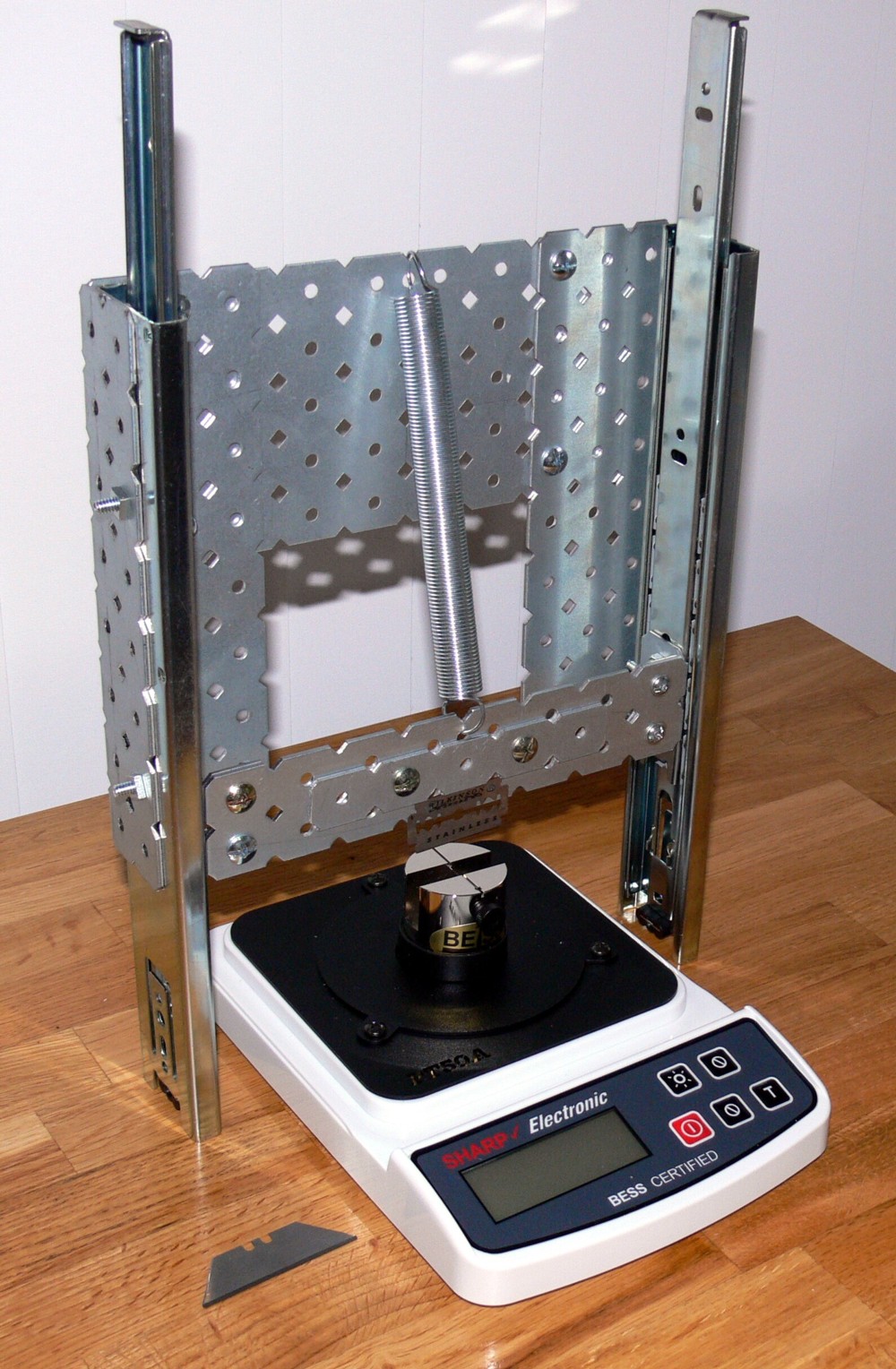

Having been using the edge sharpness tester from Mike Brubacher for two years, I don't shave forearm or do hanging hair tests anymore, as the BESS score itself tells me everything.
These traditional tests are no more than historical for me, but I will always be feeling sentimental about them as they've been the only means guiding my sharpening for decades.
But as fellows not having the sharpness tester kept asking for some guidance, I did these measurements for them.
The BESS and apex width values I give for these tests is the earliest attained sharpness (from the dullness end of the range) when the test can be performed more or less cleanly.
And let me re-iterate that the instrument reading - the BESS score, tells the edge apex width only to a first approximation for these "traditional tests".
As our knife community feedback was overall positive, we did a more thorough series of tests for the Australian Knife Magazine.
The tester accuracy is very high, repeatable and exact when done under controlled conditions; so accurate that detects difference in sharpness of DE razors of different brands, e.g. it clearly distinguishes a Feather razor from Gillette.
Feather razor scores 30 BESS, i.e. about 0.05 micron edge, while Gillette scores 40-50 BESS i.e. closer to 0.1 micron edge.
Check for example the razor study done with this instrument by Chase Anderson at https://www.refinedshave.com
I have no need to convince anyone, as I've built my sharpening business on these testers and our computer software, streamlined our sharpening protocols, and we now do volume sharpening 5 min per knife bringing each edge to 0.1 micron edge apex width for mainstream brands, and near 0.05 micron edge for high-end.
Note that the Gillette razor has 0.1 micron edge.

BESS Score - to - Edge Width correlation is true in the scale range from 10 to 400 for a polished edge of finer-grained steels and CPM; but not for ragged edges and edges off a coarse grit with pronounced toothiness. The correlation was established by matching the sharpness score to the direct SEM measurements, and BESS sharpness testers are calibrated to show edge apex radius in nm.
This sharpness tester is spot sampling.
Though a BESS calibrated edge sharpness tester is a great tool to determine the degree of sharpness, by itself it is not sufficient to verify quality of the whole edge as it samples only one point on the edge, even when you take a couple of measurements at its different portions.
At Knife Grinders we check edge by two devices used together: a BESS PT50 edge sharpness tester plus Razor-Edge edge tester.
While the BESS sharpness tester is spot sampling, the Razor-Edge edge tester checks condition along the length of the edge, and used together, they give pretty comprehensive idea of the whole edge quality, and this tandem is our QA method at the end of each sharpening session.
Yet, measuring the edge sharpness with the PT50 tester alone at the same spot on the edge will suffice for guiding your sharpening session in the right direction.
For example, how we use this BESS edge sharpness tester in honing.
We keep honing while the sharpness score keeps improving (i.e. lowering), and stop when the reading has stopped changing.
At this point, should you continue honing - you will lose the edge sharpness you've just achieved.
At this point the right thing to do is either to change to a finer hone, or just enjoy the best attainable sharpness you've already got.
Want your edge to shave - hone it to 150 BESS, but want it to split a hair - change to a finer grit and continue honing to about 120-90 BESS, and then change again to the finest grit and go on honing to 70-50 BESS.
The BESS edge sharpness tester indicates those breaking points in the sharpening sequence, where you have to change to a finer grit, and not to ruin the edge by overhoning.
You know you are overhoning the edge when the BESS reading increases.
When I see this, not only I change to a finer grit, but may also take a shallower honing angle.
We use computer software to control angle of grinding and honing with 0.1 degree accuracy, that allows us to maintain the same edge angle through the whole sharpening process.

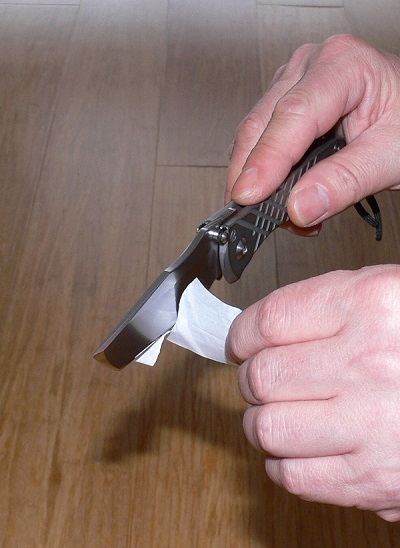

Cigarette paper test - slice the edge furthest from fingers holding the cigarette paper horizontally, then push-cut down.
Becomes possible at 30 BESS or 0.06 micron edge, but cleanly performs only at 20-25 BESS or near 0.05 micron edge - requires the same level of keenness as the top hanging hair tests.
The vertically held cigarette paper requires less sharpness at 110 BESS, i.e. about 0.2 micron edge, which is close to "scary sharp".
This one is a highly precise test due to standardized "test media", and I replaced with it the toilet paper test in the sharpness chart on our website Sharpness Chart >>

The only knife in my collection that passed the cigarette paper test held horizontally was a CRK Umnumzaan Tanto.
It scored anywhere between 20 to 40 BESS on the tester, and with that much dispersion I had to resort to other methods to determine the exact sharpness needed for this test.

Horizontally held - for high-end knives and razors, vertically held - for kitchen, butchers knives and alike.
Since this test requires the same level of keenness as the best hanging hair tests, it is a good alternative to the HHT.
It is actually a better alternative, because human hair aren't that uniform as this paper.
