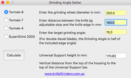

We turned Verhoeven's trigonometry into a computer algorithm, to set grinding & honing angle with 0.1 degree accuracy on all slow wet rotary grinders, and paper wheels. By now hundreds of sharpeners on every continent use our software http://knifegrinders.com.au/05Equipment_scripts.htm
