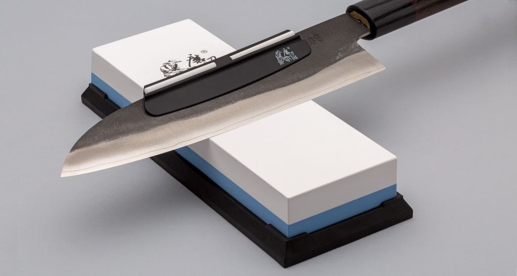

Right, the apex is razor sharp right there at the base of the burr, you only have to clean it gently.
Master your honing skill on higher carbon harder knives, but not too wear resistant - they are easier to deburr cleanly w/o rounding the apex. E.g. blades that have carbon content 0.8% - 1% and hardness of HRC 60, but are not super-steels.
Deburring softer (and cheaper) knives is way more difficult.
A shortcut to sharp edge are knife sharpening guide clips, like on the photo - use the same guide through sharpening and honing.
There are many comprehensive honing/stropping threads on this forum, e.g.:
https://bladeforums.com/threads/stropping-angle-plus-pressure.750008/
and
https://bladeforums.com/threads/stropsanity-compounds-substrates-and-the-godstones.1570661/
