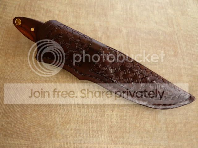

I'll add to the pile recommending the Chuck Burrows DVD. I believe it has advanced my skill set by years (I started with zero leather experience,) and I refer back to it frequently. The only problem is that a bunch of guys (myself included!) seem to be making the Chuck-Burrows-DVD-pouch sheath ;) Here's the last one I made, I think it was my sixth sheath, so not perfect but again would have taken me several years to get to this point without the DVD.
