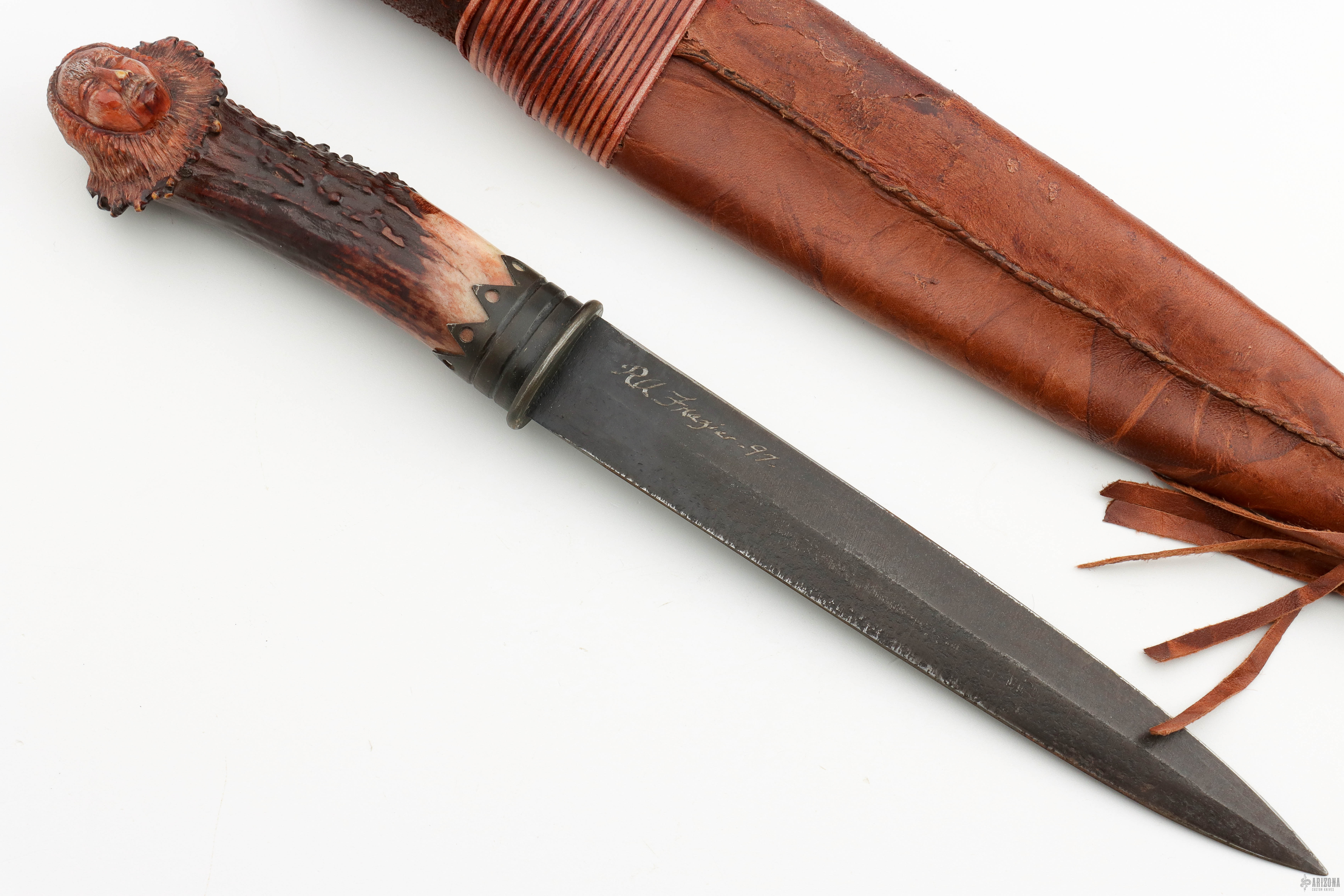

I am finishing the second blade I made for this project, and I am currently doing the scabbard. I am soliciting suggestions or tips because this is my first one.

Other sheath guys may have a different preference, but I like the stitching down the back side.

For sure, that would look better. But like I said, I am trying to avoid wrapping the leather around the curves - I see that as a potential problem. Hence the side seam idea. But it's not done yet, so I can change the plan.
(though now that I think about it... maybe I am not avoiding the wrapping at all... let me sleep on it :) )
If the leather is dampened properly, you can stretch it and stitch it up, then let it dry and tighten.
I usually don't stitch or dampen the leather. I apply the glue (leather weld) to all the wood except a 1/2" wide stripe down the backside. I stretch the dry leather as tight as I can by hand and use strong clamps (HF metal spring clamps with the rubber tips removed) to pinch the leather tight at the back seam where there is no glue. Work out and wrinkles and adjust the clamps as needed. Let the glue dry. Once dry you can either stitch the seam tight and trim the excess, then pound it down ... or ...
Trim one flap of leather to cover 3/4 of the exposed wood. Fold the other flap over it and use a very sharp blade (I use a scalpel) and cut through both layers of leather in a straight line down the center. Remove the cut-offs and the two pieces should meet cleanly in the center. Apply glue and push them tight together with your fingers as the glue sets up. Remove any squeeze-out with a damp paper towel. Cover with waxed paper and clamp a piece of thin wood or plastic over the seam to dry. Put cardboard/wood/plastic on the other side so you don't put clamp marks in the good side of the leather. The seam can be almost invisible when dry.
For these type sheaths I use mostly black buffalo leather. I use a sharpie to touch up any spots on the seam that need it.
Kudu, ostrich leg, frog, lizard, snakeskin, etc. all work well with this technique.
Ron Frazier taught me the above method. His sheaths were often nicer than the knives in them. Like Ron, I use a silver throat sleeve and a silver tip-cap to finish it off, but you can just leave it all leather. For a simple tip-cap you can braze up a small cone, shape it to fit the sheath, and then file the tip and add a small solid ball of metal as a finial. As used below by Bill Moran, Ron used a wooden or steel mandrel makes shaping simple.
Bill Moran used a thin steel throat sleeve, and a tip-cap that he made in two pieces of steel and welded together. He shaped these on a solid copy of the sheath that he could hammer on.
BTW, you don't have to use water to moisten leather for shaping/molding/marking. Alcohol will do it as well and dry faster.
Use a 50:50 mix of 99% isopropyl and distilled water.
