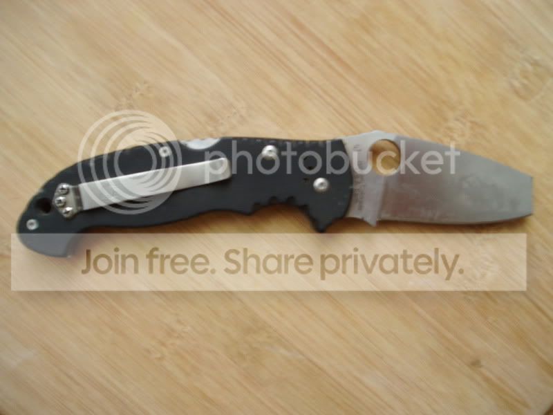

Let's start with the picture..
Now the story..
This Manix I've had for about a year. It has seen a ton of hard use. When I first got it, I was a landscaper, and as soon as I got this knife, it became my new carry knife. It cut sod, line trimmer (weedeater) line, brush on occasion, and was used for pruning once when no pruners were thrown in the truck and some rose bushes needed pruning.
Next, this Manix saw use during a job doing window prep and other waterproofing on new construction. It was used to cut Tyvek and other small jobs, and one day, it was used to cut roofing flashing when no tin snips were around. This was performed by batoning the Manix through the flashing with a framing hammer. Light marks were seen on the spine afterwards, but other than that, no real damage other than some dulling occured.
Finally, let's get to how I broke it.
I was working the past few weeks planting perennials and decorative grasses in a field. We had to move irrigation one day, and some branches were getting in the way. Thinking nothing of it, I pulled out my Manix, found a suitable baton, and batoned my way halfthrough the offending branch (2 inch diameter) when I heard a bit of a snap or ping, saw 3/4" of the tip of my Manix missing, and felt a sick feeling in my stomach. The baton must have hit at a poor angle resulting in a break.
The break is, for the most part, straight on. It did not tear, but instead broke cleanly. I have contacted Spyderco about the best possible course of action for repair or replacement of the knife, and they said that all they could do was regrind the tip... I have access to grinders and cooling tanks, so I think I'm going to do it myself..
A question I have for you folks is: What type of tip would you like to see on this Manix? I've considered several things, including a straight on 90 degree prying tip, an angular reverse tanto type point, or bringing the drop point down in a curving manner. Suggestions?
By the way, I truly hope this will be taken in a positive manner. I'm not trying to start controversy or bash Spyderco. In fact, I can totally understand that this was completely my doing, and although in my opinion batoning is not necessarily misuse or abuse of the knife, accidents do happen.
There ya go folks! Hope it was interesting for you to see.

I'd be fun to keep the blade shape as is, but grind that nice big vertical edge like a chisel. A bit OT, but I like your home jimping, how well does it help with retention?
The jimping works extremely well. Along with the texturing on the corners, I sanded the clip side of the G10 down slightly so it wouldn't tear pockets, and the tension on the clip has been increased a fair amount.
Another note on the jimping: I did it mostly for better retention with gloves. There is no way that this thing will pop out accidentally, even with extended use in wet conditions.

Jeffrey, to be honest, what you said came off a little strong. To say that nothing that I described is proper use of a knife is a little bit exaggerated. I use my knives, and my Manix I have used the hardest. It has been necessary at some points in time to abuse it, and when I did such, I understood the risks I was taking. I "thought nothing of" the Manix in a batoning manner because I have done this several times before with little to no damage. Obviously, my attitude allowed me to make a mistake.
Sherlockbonez, I was hitting the knife on the blade at the only place the blade was exposed, which was near the tip. The angle at which I was batoning allowed a glancing blow quite easily, which resulted in the break. This has taught me that I should take more care in directing each hit with a baton in a more controlled fashion.

I would also say that the only mistake you made was sloppy batoning, and I doubt the blade would have broken had you been using proper technique, which is just an honest mistake. That knife is made to be used hard, so don't let anybody make you feel bad about how you chose to use it.
If you choose to regrind, a stout reverse tanto type shape would probably serve you best, leaving some tip to work with, but still being stronger than the original, thin, leaf-shaped blade.
