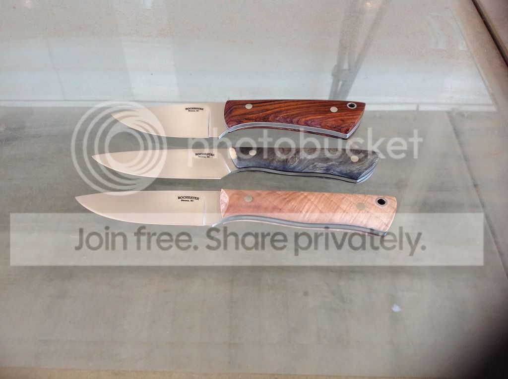

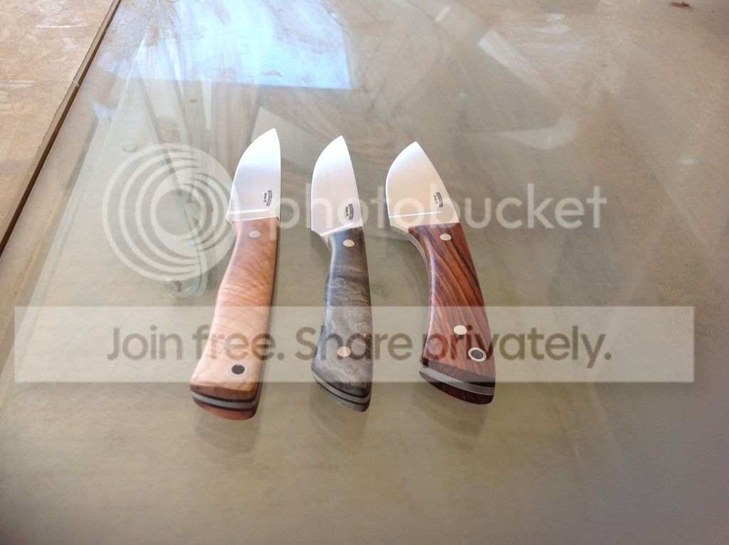

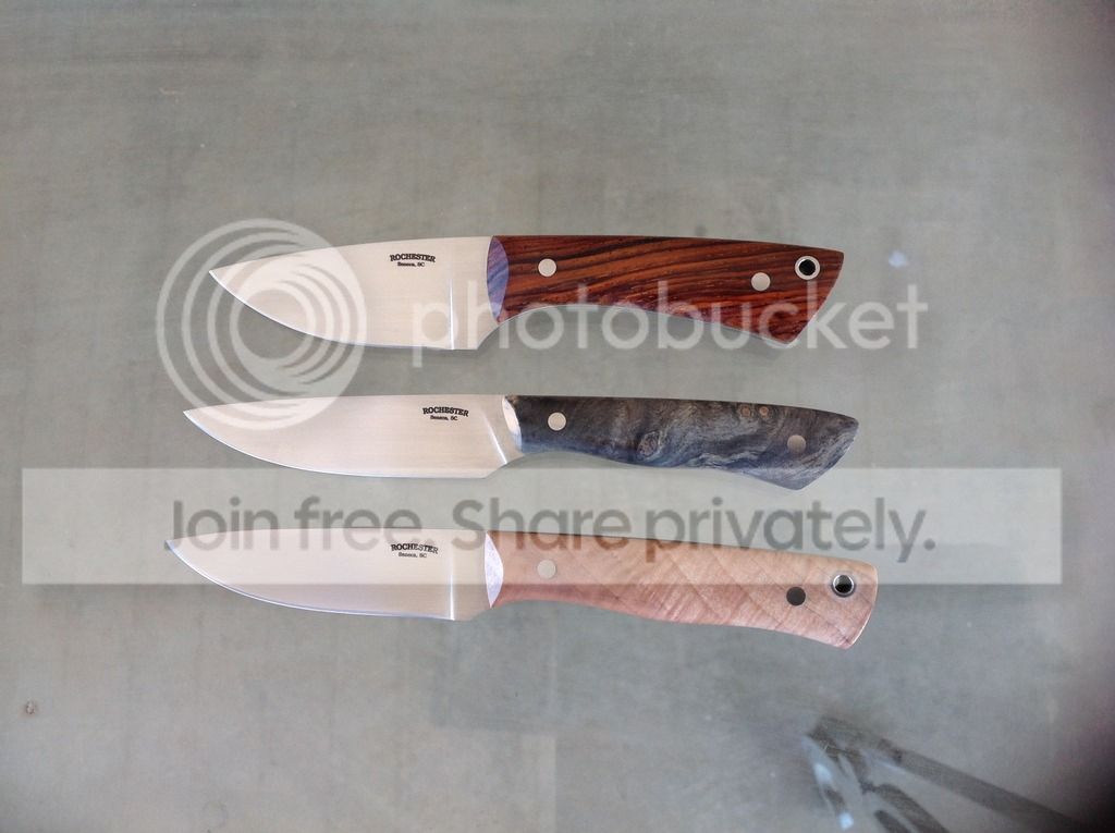

I am usually finishing knives for gifts til midnight on Christmas Eve. Well I'm finished a little early this year and it feels great! I love making knives but I especially love giving them as gifts. These are all Cpm154 at 61rc. The top is one of my skinning knives with cocobolo scales and white g10 liners. The middle is a paring knife with California buckeye burl and black g10 liners. The bottom is one of my Bird & Trout knives with figured maple(from Greenberg woods) and the clearish green g10 liners. I hope everyone has a Merry Christmas or Happy Hanukkah! Feel free to share pics of your Christmas/Hanukkah knives.
