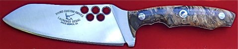

That's one of my Rhino Chops that get a lot of use in our kitchen by both the wife and myself. Great for chopping veggies, stew meats and many I sell have a sheath for camp cook work.
3/32" x 6 3/4" x 2 3/4" of CPM-154 RC 60 from Paul Bos HT and Blue Pearl Kirinite Scales with Loveless type S/S bolts.

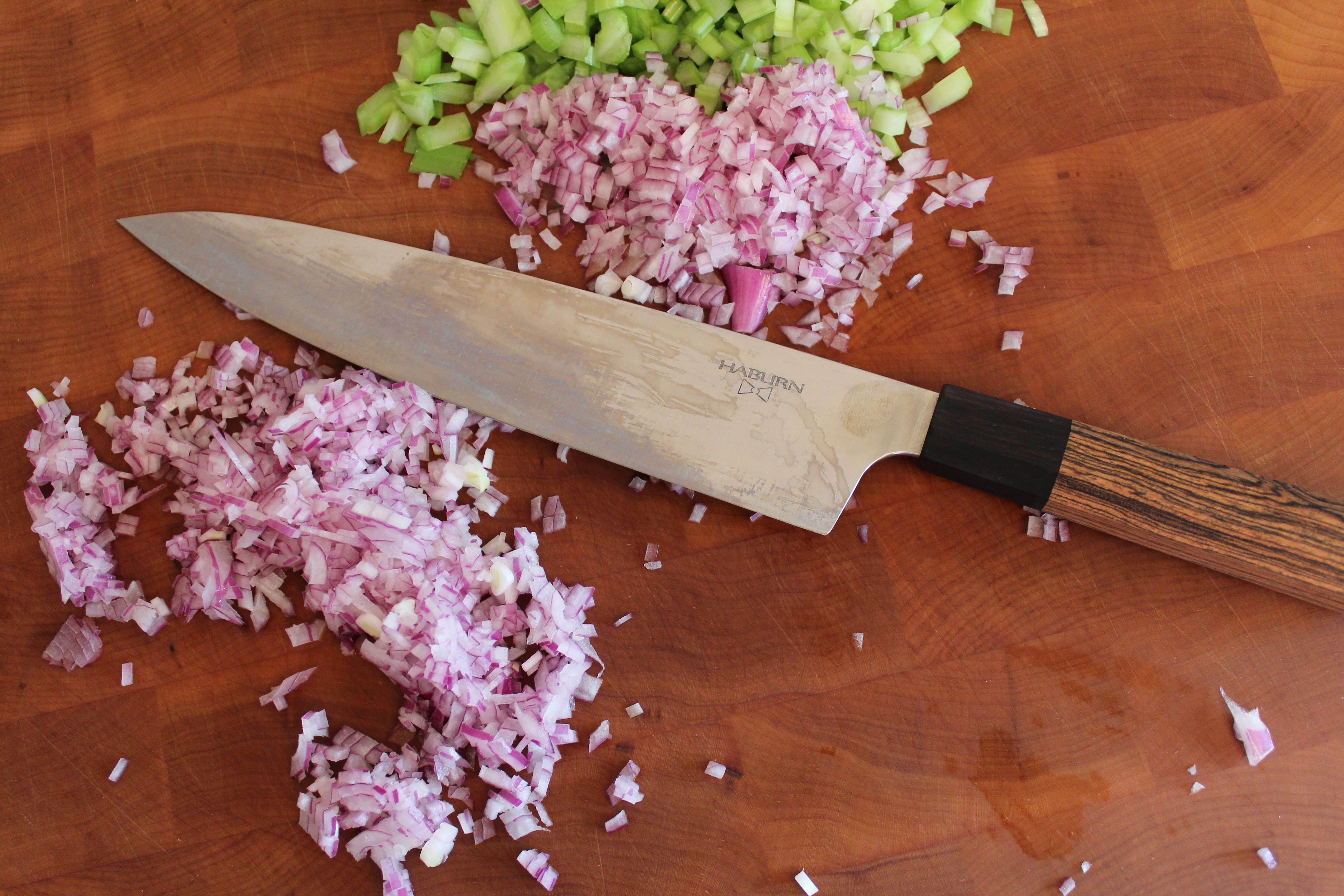

Here's a new Haburn gyuto that I picked up about a month and a half ago. She's made out of 52100 and has a very slight concave grind and a wicked distal taper. She literally floats through onions as if there was nothing there, which makes this knife a dream to use.

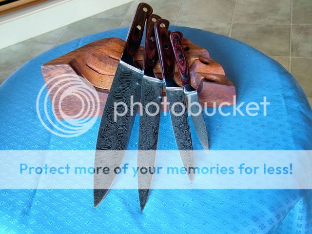

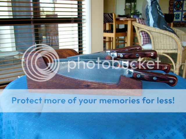

I'll play, this set of knives is very well travelled, made from Damasteel, its been all over Australia at a number of shows and to Blade back in 2008. I said to my wife Robynn if I bring it back with me we are going to use it and so there you go.

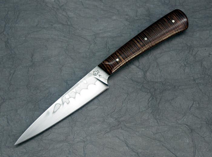

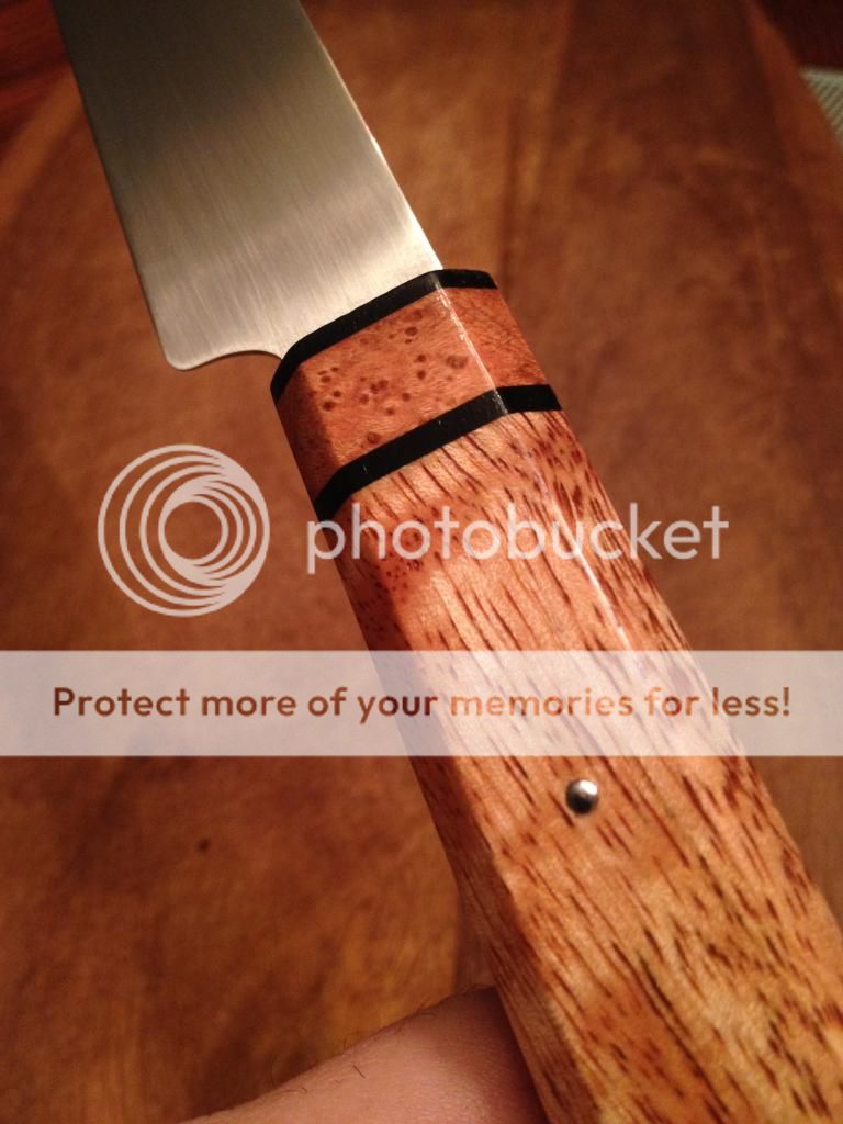

Here's my second attempt at a kitchen knife. I really like small utility sized knives and I wanted to try a chisel grind Japanese inspired design.
The steel is 15N20 with a curly Hawaiian mango handle and mycarta and black cherry burl ferrule.
