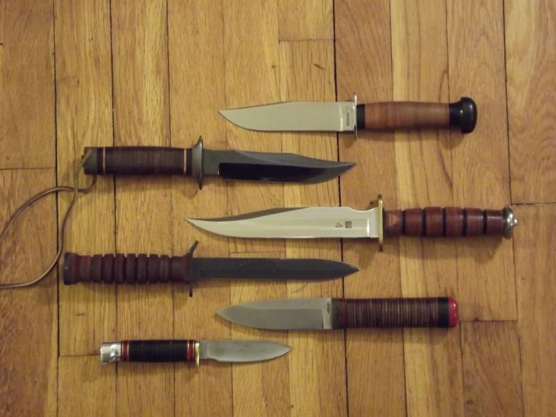

From top to bottom; Boker Mk I, SOG Original Bowie, Al Mar Grunt II, Camilus Mk 3, Blind Horse Knives custom, Hess Knives Muley.

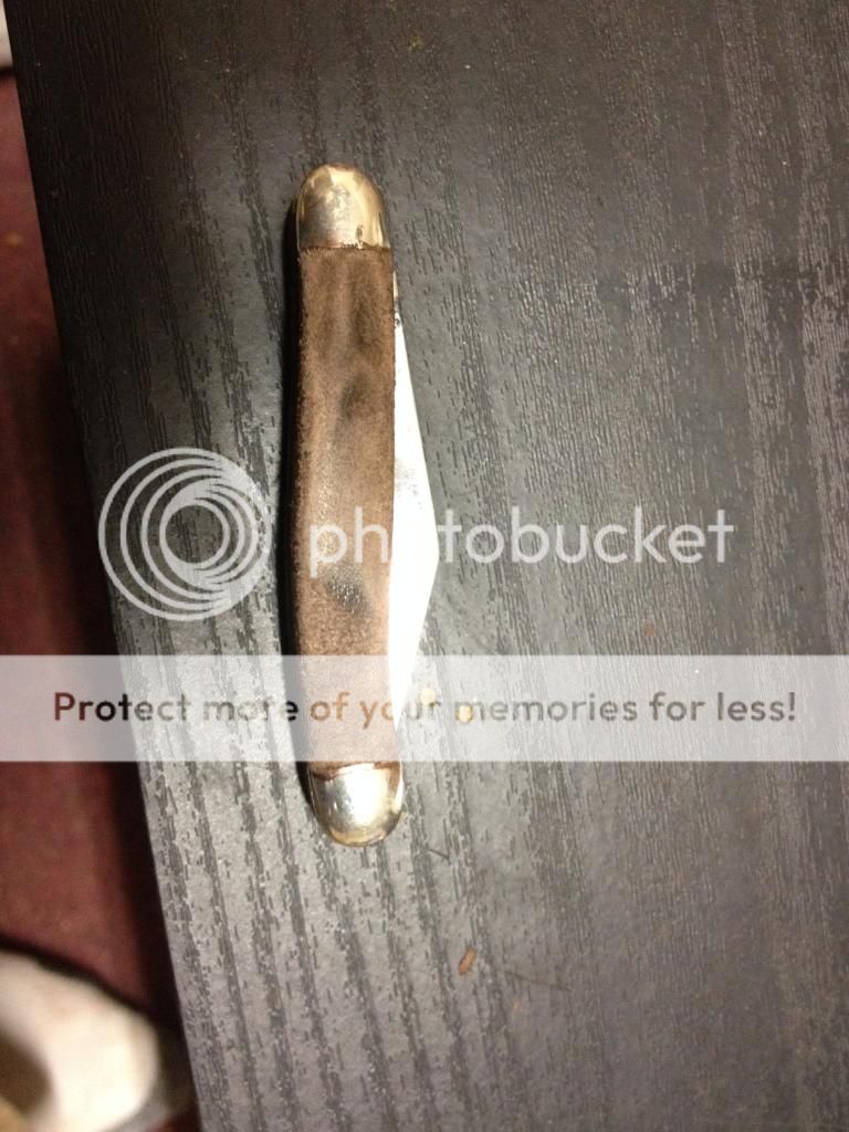

Ladies and gentleman, there does exist one leather slipjoint that I know of. :)
This little guy is a kingston slipjoint I found at my great grandpas house and it originally had these cheesy plastic scales that I hated. So I popped them off and glued some thick veg-tanned leather onto it
Here it is with te scales off and the rocker pin peened back down
This is it dyed and sanded down some
Then I saturated it with superglue to harden it. And did some more sanding
Here it is with the final sanding and buffed on the buffing wheel
It looks and feels almost like horn. I did that probably 6 monthes ago and it's held up very well. The finish has dulled some but it polished right back up on the buffer
