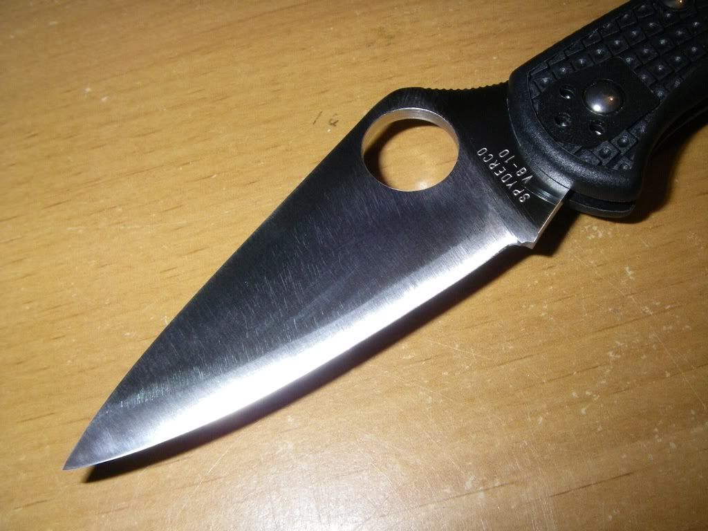

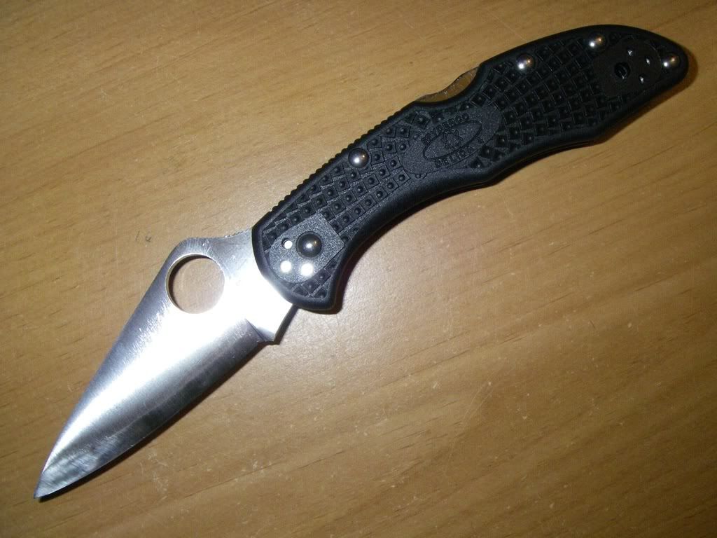

I wasn't too keen on the severe upsweep of the belly on my Mora 2010 (Borrowed pic):
So yesterday I sanded down the spine to make my 2010 more of a spearpoint:
Much better!
