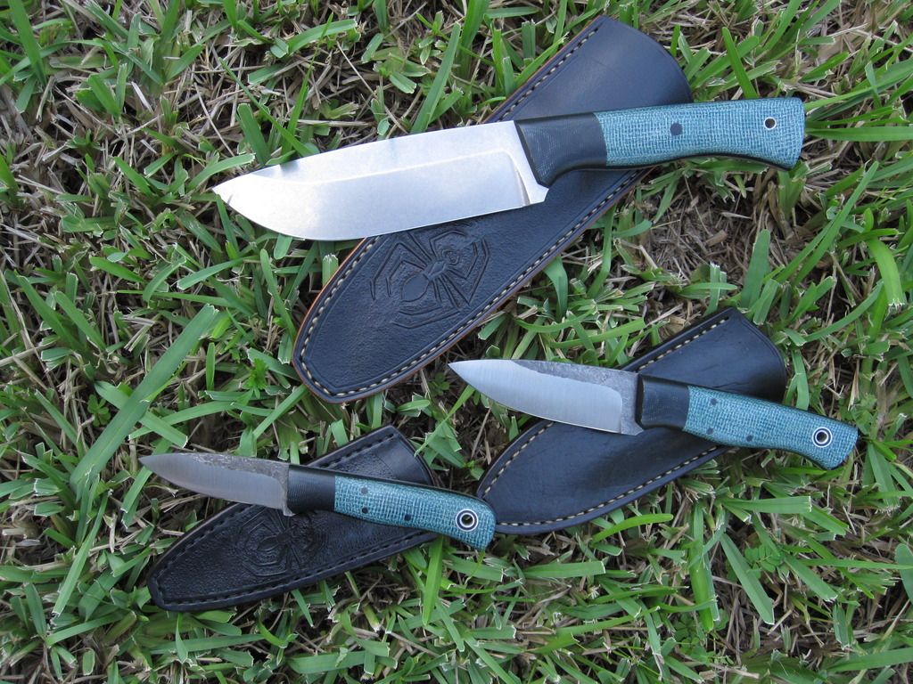

A couple more from Bud that have paired up well. The PK is my EDC at the moment.
Looking good Abe! I really like the Pocket Kephart for a front pocket EDC. Gotta start carrying mine more often.
Thanks Double Barrel. I think it varies from knife to knife, can't see the liners from that angle on my other runt.
I didn't think I had saw that before. It's a nice touch. It kinda looks like it's outlined. I'll pm my address, in case it ever wants to go on vacation to the states...lol

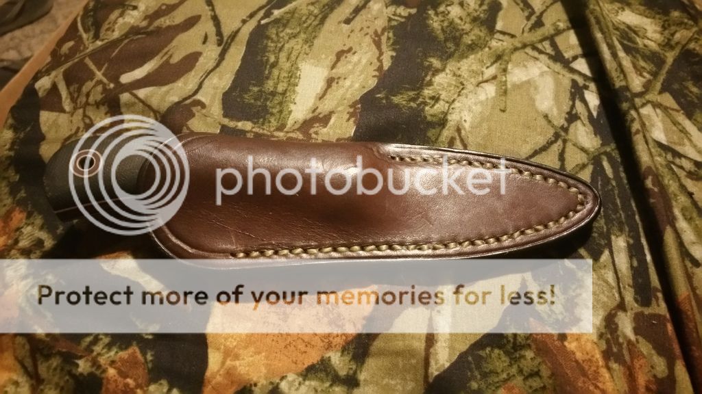

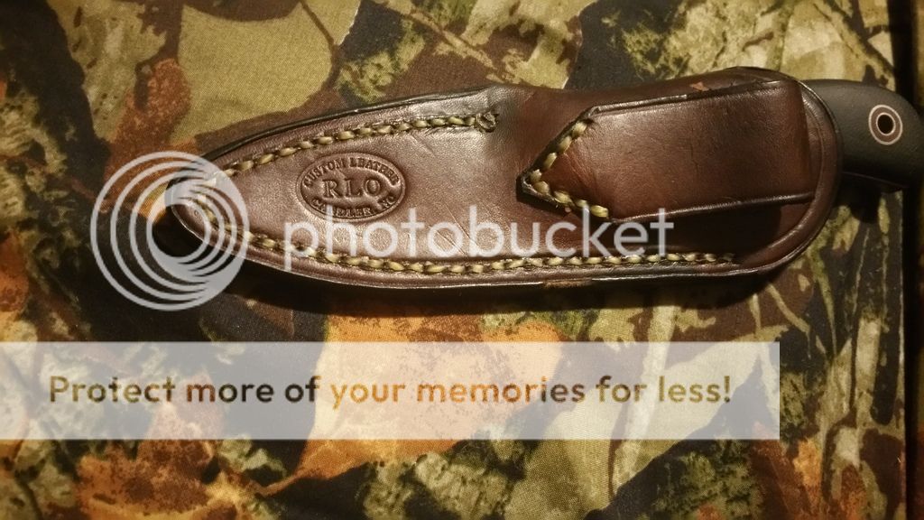

This sheath was my edc for the Lonestar. One day I got it snagged on a work bench, and tore a couple thread threw the leather on the belt loop. So I was going to retire it, but then i got a wild hair tonight and decide to fix it the best I could. I had to restitch the whole thing, so I used synthetic sinew. It looks better in person, I know Mr. Rick would have done better. (Imo)
I honestly don't think I could have done it a bit better! Artificial sinew is unbraided waxed nylon and super tough, so makes a good using thread. On top of that, it sure fits right in with the sheath color. Well done.
I just followed your wholes pretty simple thanks tho I know there's got to be a better way to hide the starting/finish points tho. I do love the look of "sinew"
Start two holes below the first hole and go backwards, then stitch right back through those and continue. At the end, just back stitch two and a half which will leave both thread ends on the back side of the leather. Cut the ends and melt them back into the stitch.
