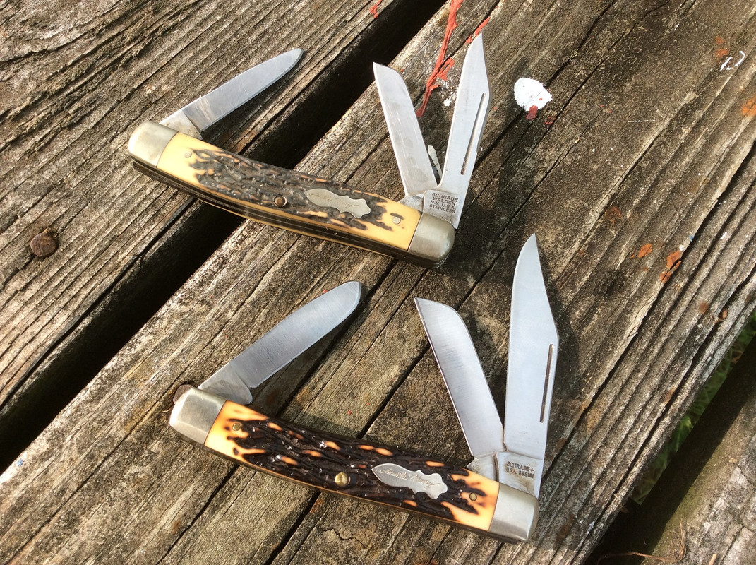

My favorites are the Uncle Henrys (I prefer stainless) and the older Waldens and Cut Cos. Here's a few faves.
Schrade made some fantastic knives and I've picked up a few along the way. The 93OT is one of my favorite designs because of it's size, serpentine frame, the blade combination and it's rounded bolsters.
Here's a couple that together show both the sleek Turkish clip and the robust Sheepfoot blades that Schrade used.
