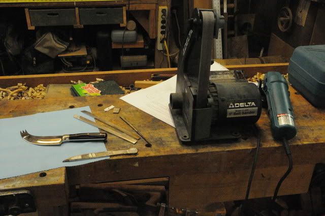

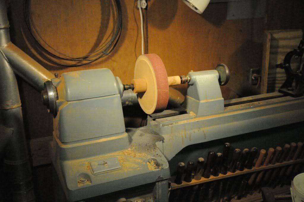

This is called "makin'-do-with-what-ya-got":
http://i1179.photobucket.com/albums/x384/woodwrkr221/ROB_3561-1.jpg
Before you ask, yes, this rig is only to be used at low rpm. If I dial the rpm up to high the belt will indeed reach out and slap me upside-the-head. Ask me how I know this.:o
And here's another one I have:
http://i1179.photobucket.com/albums/x384/woodwrkr221/ROB_3558.jpg
This pic was taken just after sharpening the knork. in front of the knork you'll see a little Wharncliffe utility knife I've cut out but haven't profiled yet and also a couple of marking knives to use in the wood shop. I decided to make the Wharncliffe utility to see if I like a Wharncliffe as much as I like a sheepsfoot. I suspect I'll like the Wharncliffe even more.
