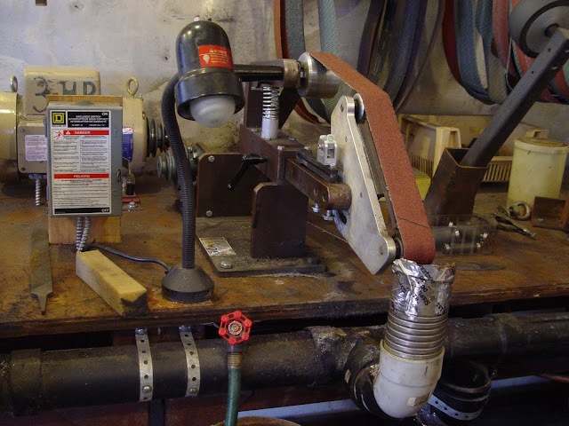

This KMG is run on a 3 HP motor with a six inch drive wheel it has three speeds slow medium and blazing; around 5400sfm. I have a 5 inch wheel and a small wheel arm to go with it.

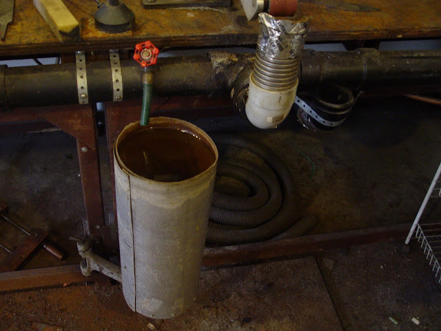

The quench tank swings on a pivot, it is topped up from the little hose bib above it. It can be moved from grinder to grinder position as needed. The pivot is made from one of those seats we had in 9th grade lab, that were hinged to the tables at the corners.

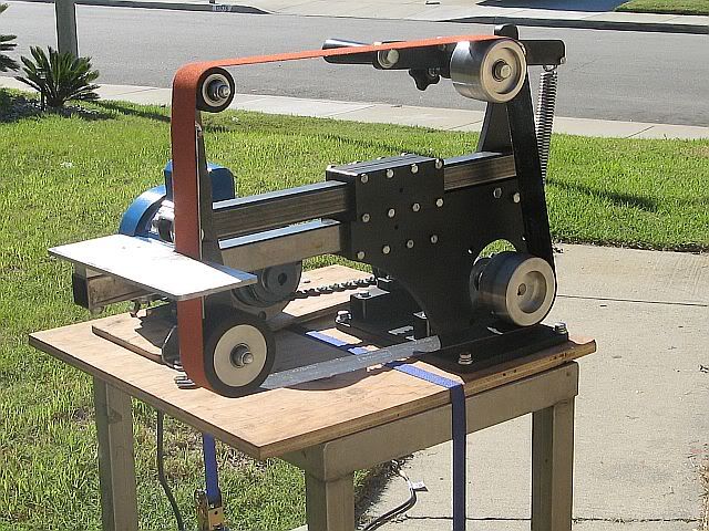

This is a mobile 2X72 grinder that can be taken with you or set up in the shop in whatever location its needed.

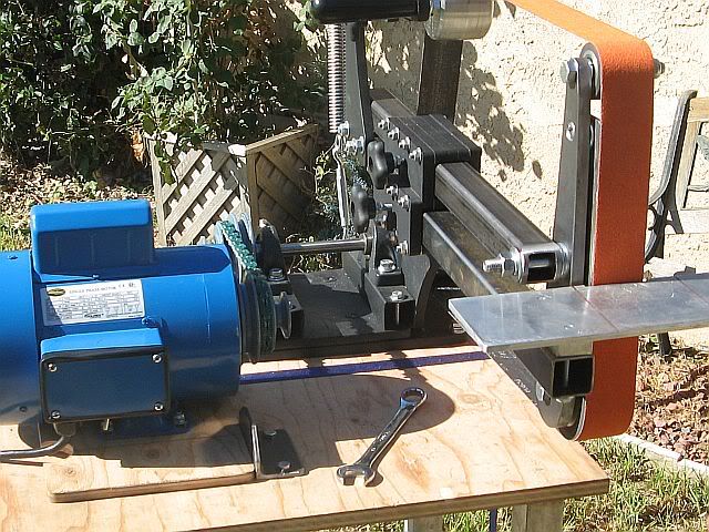

This side view shows the construction of the adjustable work rest. It moves up and down as well as in and out. It came off a mobile miter saw.

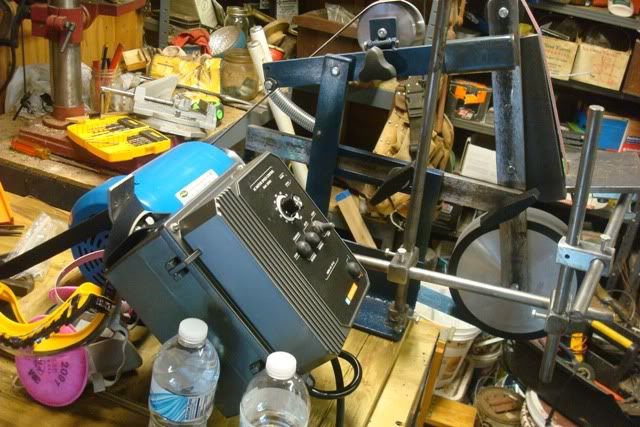

First off is a GIB with a 1.5hp DC motor and a DC Drive. Behind it is a 1x42 Kalamazoo

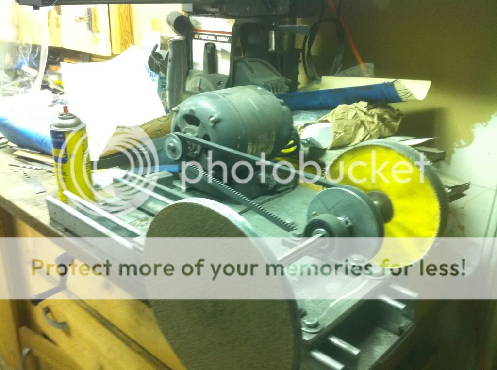

Along with a homemade disk grinder/buffer. The buffer is only on when in use other wise it is off so it doesn't get grit in it.

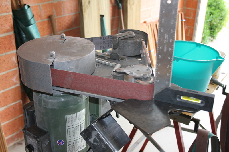

As for grinders I have a variable speed Radius Master. Quite versatile little machine in that is can double as a horizontal grinder as well.

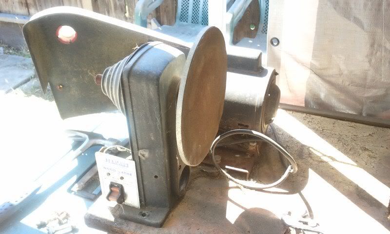

Here is my converted wood lathe turned disc grinder. I also have about 30 files in all shapes and sizes that get more use than the grinder.
It has been cleaned up and I am needing to put a second disc on the outside.

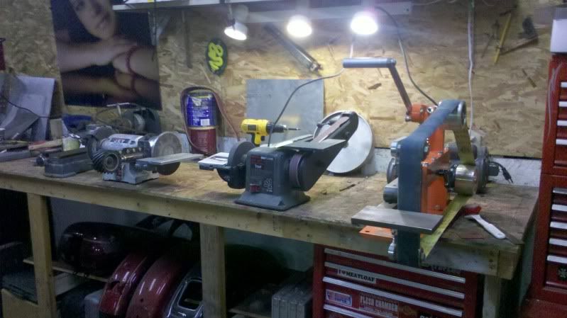

Very cool Fred! Here is a shot of my grinding area.

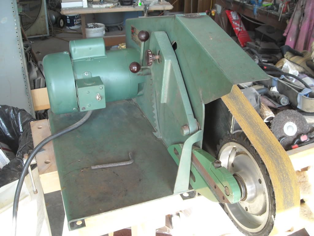

Heres my Wilton.Thanks for the chance.754 please.

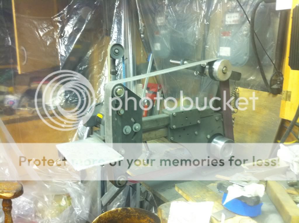

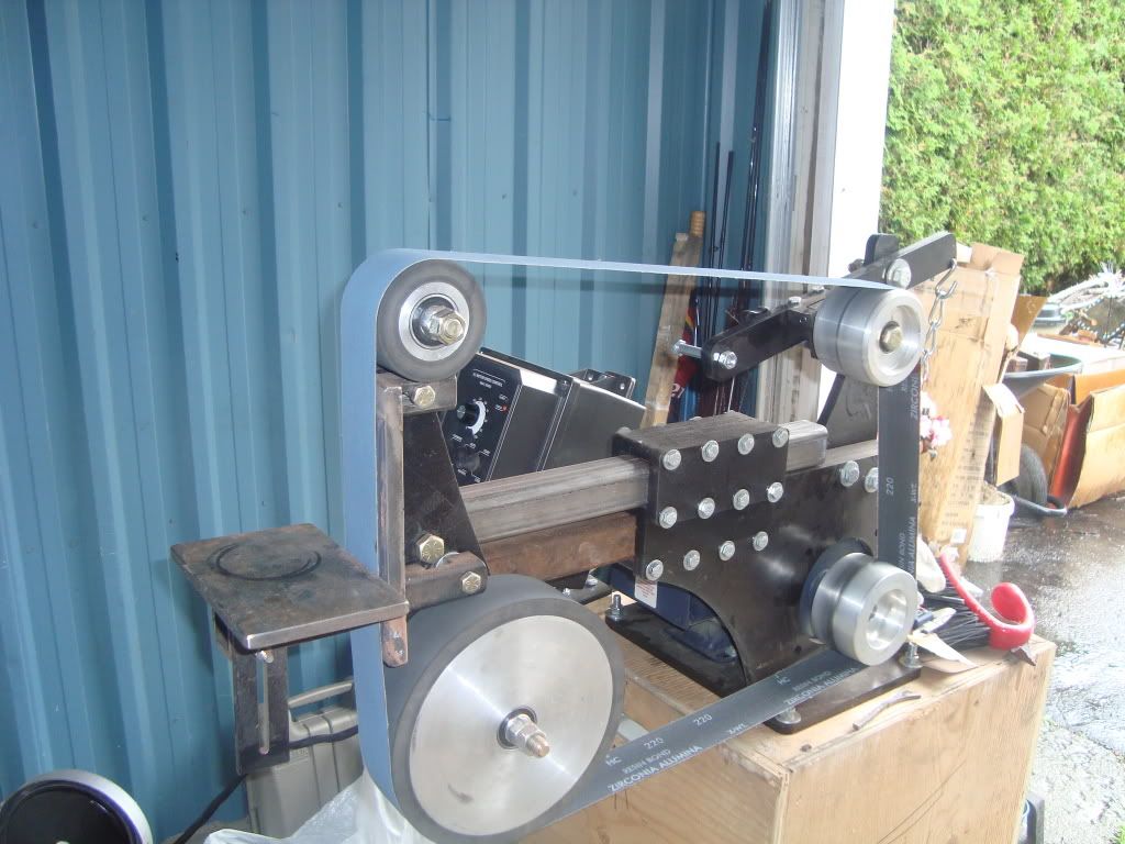

I'll take 444 please and thank you. Here is my GIB build fresh out of the create from my move this spring.
I didn't even have a bench made for it yet, but I had to grind something so I just turned over the create wired everything up.

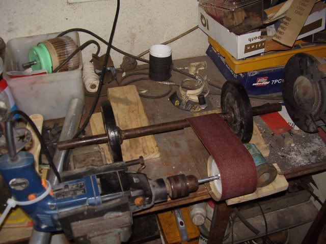

Well....this is mine.....ground 3 blades on it thus far.
Been cleaned a bit more, but the setup remains the same.
Made from my fathers drill, a 2cm drill bit, a hard plastic tub that was used for cream, added sandpaper for grip to the tub, a dumbell with weights to keep the tension in the belt, a piece of wood to elevate and keep the dumbell from rolling.
