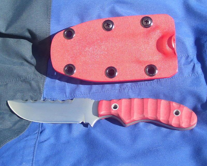

This is a prototype of a blade I designed and made by Scott Tanguay on the handle of one of his Little Pricks (I think). It was designed for a specialized purpose. This knife is an O-1 prototype.

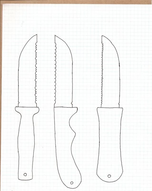

Here are some of the old drawings I made of that blade fitted to different handles. The serrations are different and we settled on the large scallops when the proto was made.
This is Scott's pic of the knife shortly after completion. You can see I've used mine commercial fishing.

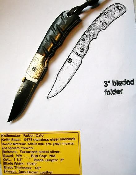

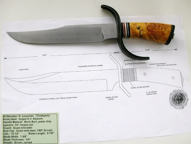

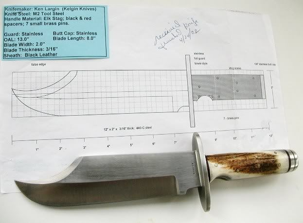

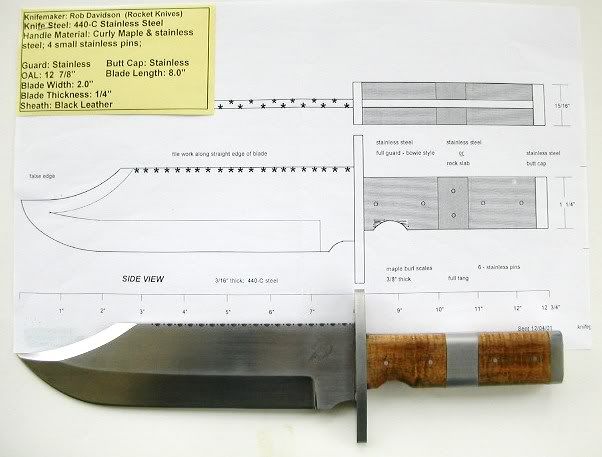

My small collection of ideas turned into knives...
2002
2003
Ron & I went back and forth with this one to satisfy ourselves... I was just glad that he used my poker chips as a spacer and 'punched out' coin on the butt.

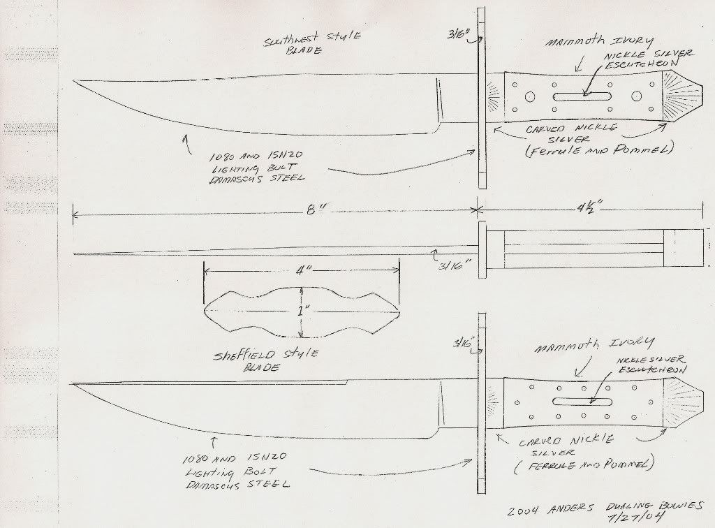

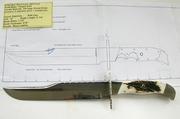

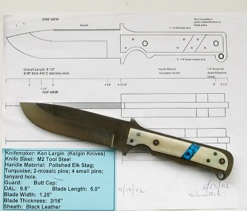

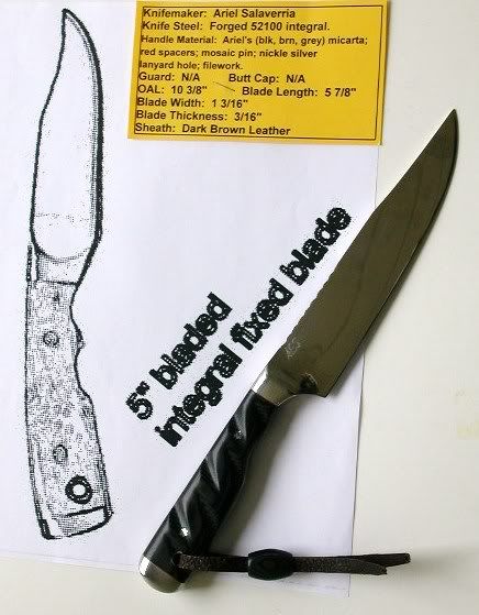

I sent a drawing to Ariel & Ruben and asked for ideas if they'd be interested in doing a collaboration.
I don't usually supply a maker with design drawings when I order a knife, but in most cases just specify basic style, ideas, materials and specifications.
However, on occasion I will draw the knife such as this set I designed to help commemorate David and Jerome Anders becoming the first father/son ABS mastersmiths. This was the first such set of which they were to do one each year. Not sure who owns this first set, however the second set is currently listed for sale on BladeGallery.com. The below was actually a full scaled drawing before I reduced it to post here.
The completed set in it's display case is shown below in a scaned Blade Magazine article on the Anders (July 2005).
