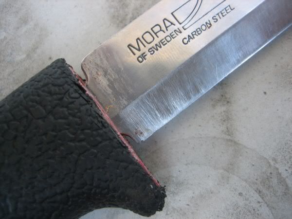

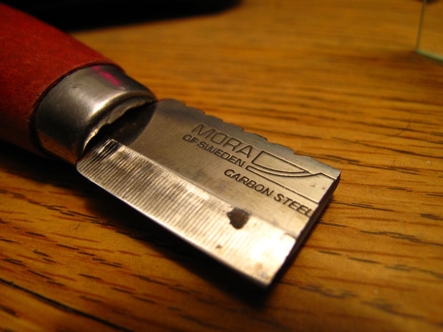

Mora #2
Mora 711- Pulled out and is hanging on by a little plastic.
