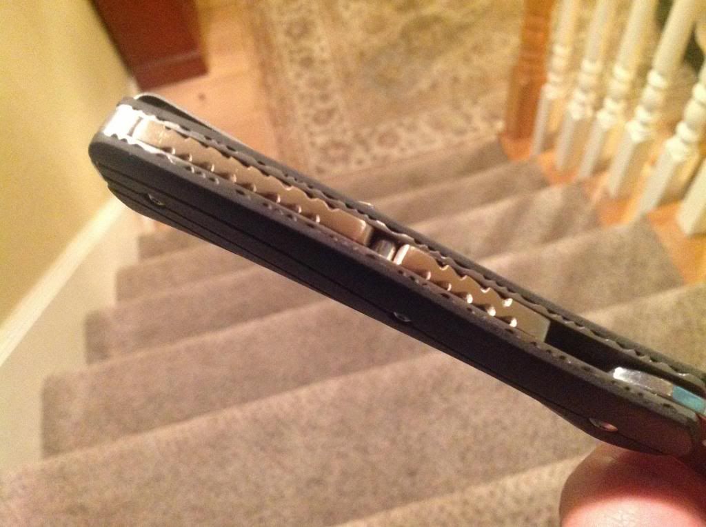

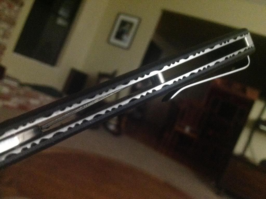

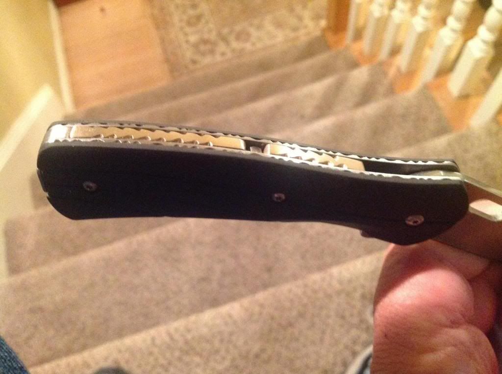

Pimping my Buck with some micro-file work. Great practice for bigger work to follow.
Thanks about the filework. Couldn't leave the small Vantage alone, it has been such a coin collector over the year that I finally decided to modify it with a liner spacer of bronze. Some filework and a couple of set screws and no more jammed Buck. There is a side benefit that it added a little mass to the handle and it now feels a little more substantial.

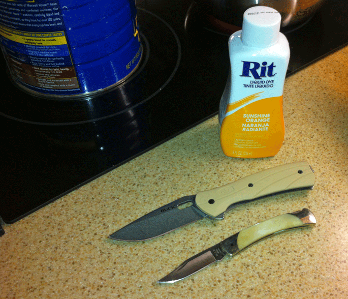

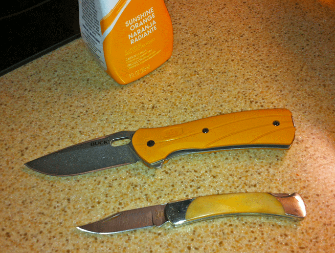

How about an orange one.
Before someone asks - You have to dye a beige handle yourself using RIT dye, its easy. I think I did a thread on it and over in the Traditional forum they have done a couple.
But the sad thing is they discontinued this exact model so you will have to search for one.
The bone 55 didn't turn out to be anything exciting, will have to re-dye it sometime.
