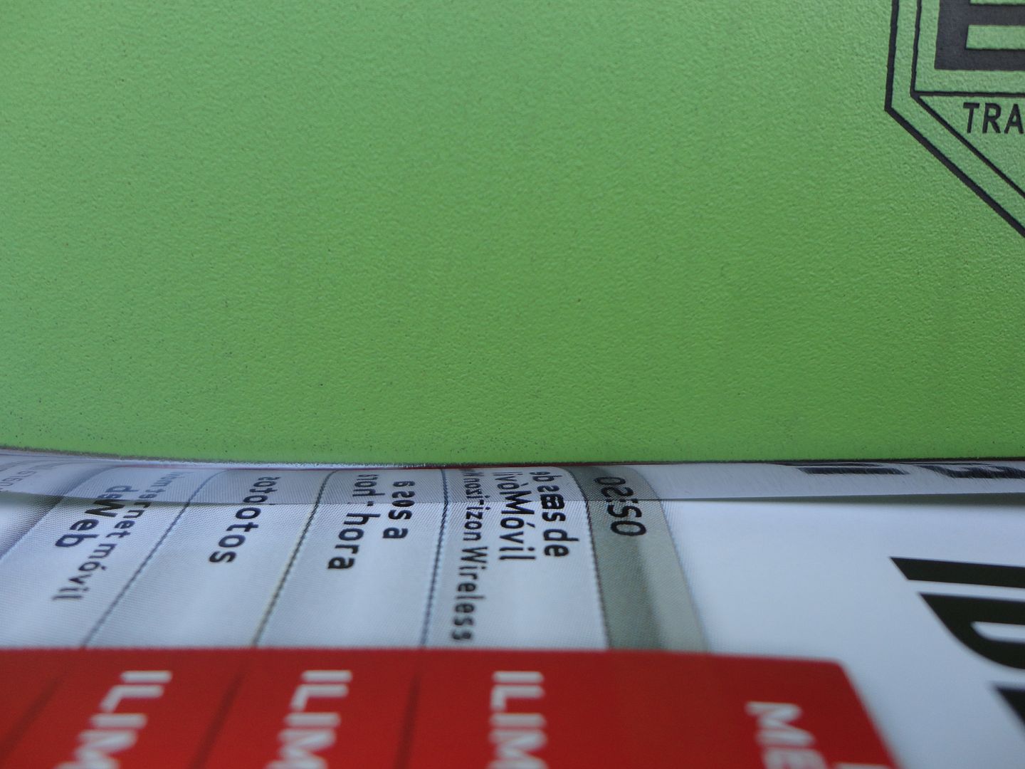

I keep recycling this photo but it's the only one I have on hand. Sometime I'll snag one of my Ratmandu or Tojiros - I only polish my carbon steel and kitchen knives. Everything else is typically at a DMT F or EF level with a Spyderco F or UF microbevel.
My bevels aren't anywhere near as clean as you guys here, but at least my edges are sharp enough to not be labeled a plebeian :D
This picture particularly shows my inconsistencies, I've seen worse though!

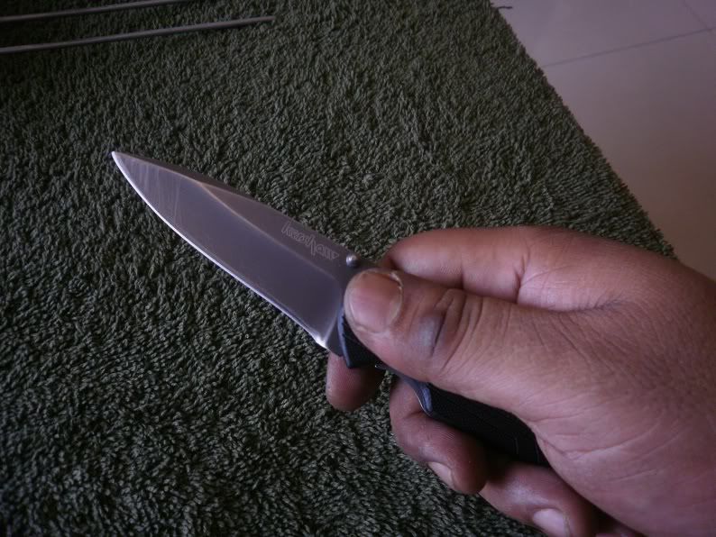

My only attempt at freehand sharpening.
Titan, I see your "inconsistencies" and raise you one totally messed up knife.
I am not giving up though. I practice on el cheapo, flea market knives now. But its like certain martial arts; you either just get it intuitively or you spend years and years becoming merely proficient. I will take the latter if it helps me get edges like I see on this thread.

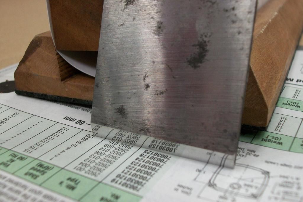

Here's one I just pounded out, will have to get some pics of some of my other tools. Vintage Stanley bevel-up jack plane blade. Took it from XXC DMT through JUMMA waterstones and finished off on a diamond jointer stone with a very slight burnishing on Washboard with plain copy paper. No jigs allowed.
