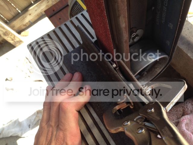

Show your jigs. Steadyhanded purists beware. :D

Well this sounds too simple too but you just follow the grind lines which means you will move the end of the sled out or in while still laying flat on the table that has the set angle.
Fred is a good guy and I've read many, many times how his jig has helped people move ahead on the grinding. It is more "free hand" too. It might help you to overall move ahead faster if you are just starting out in knife making. I went to this many years after I started and have never gone back. Frank

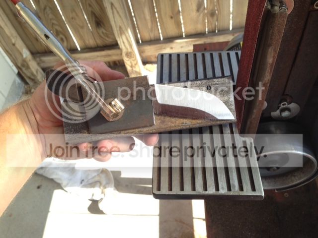

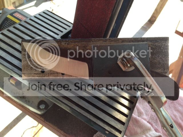

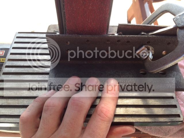

Mine is super simple but has been consistent thus far. New to making knives but just using an angle piece of mild steel has made a world of difference.
This is a seemingly common way of jig grinding and it absolutely boggles my mind! Its totally illogical to me!
Why would you want something that offers no support to the actual part being ground?
By the time you get to the tip your hand hold is so far away from the action. Your feel must be so greatly reduced!
And then you end up having to build a comically oversized rest

Your inability to articulate criticism in an nonabrasive manner boggles MY mind! ;D
Seriously though, I don't think I'm following you about the whole "no support to the actual part being ground" thing. I have one hand on the sled/tang and the other supporting/pushing the blade side into the belt. If I'm doing a big blade(like the 10in chopper I posted a pic of) I'll keep the blade-side hand towards the belly/tip of the knife. My grind lines have been coming out straight and consistent so I feel like I have pretty good control. Also, I got the idea from Chad/Adventure Sworn(link posted in OP) and I'm not sure if you've seen his work but his work definitely demonstrates a high level of control.
Again, maybe I'm not following you, or hell, maybe I'm not explaining my technique clearly. Either way, I made this thread to learn and get different ideas, and your idea sounds interesting. I think I might have seen a video of Jose Diaz making his Bushcrafting scandi blade with a jig like you're talking about.
Do you have any pictures of your setup? I'd like to see it. I'll try and get a video up of mine here in a bit.
Oh and IIRC that long ass tool rest you you posted a pic of is almost comical. I think that person was using it for swords though.
Sorry! Try reading it in a more jovial tone. You'll know when im trying to be abrasive ;)
Isnt it funny that I didnt even consider putting your hand on the blade?
Half the reason i grind on a jig is so I dont have to worry about heat as much and im never going to burn my fingers.
Im just imagining either holding the block end down or the tip end up so it doesnt just flick down when the tip is in contact on a possibly less than sharp belt.
And its just like, why? When I can have a piece of wood do it for me.

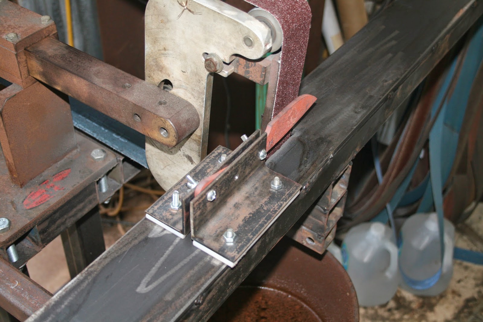

Yes that picture was from someone grinding swords, though not all the time, but the concept still applies.
You ground a 10 blade on yours so your rest extends 10"+ either side of the platen?
And by using 2 piece of angle iron like that one and yours you also have to extend the rest back behind the belt.
Which means you have to move the rest to change belts over? that time and effort adds up

It's all good, I was just ribbing ya a little.
As far as burning finger tips, I usually just use a push stick or wrap a little rag over my finger a few times. I really like being able to see over top of the edge where the belt is hitting the blade. I suppose you could cut a relief in the 2x4 to get the same view.
In regards to having the belt catch the tip of the blade and having it flip up, I've never experienced that. I'm holding the tang/sled pretty firmly and I think you would almost have to jab the tip into the belt to make that happen. With my setup I bet it would just maim the tip and on yours I bet the belt would just hit the 2x4 where it sticks out beyond the tip. Either way I don't think it's much of an issue.
Now, you make a real good point about a 2 piece design hanging off the back of a tool rest. After reading this thread though and seeing other designs I think I've thought of a fix for that. What I'm thinking is that I'm going to glue/jb weld one of the pieces of angle iron to a piece of flat plate steel that is the size of the entire jig when together. Then the bottom would be one solid piece. I might even make it a little larger than the jig. I'm not sure if this would totally solve the issue of needing the tool rest behind/to the side of the platen but i think it would help the design structurally.
Hah! That's *my* comically oversized work rest! :D
