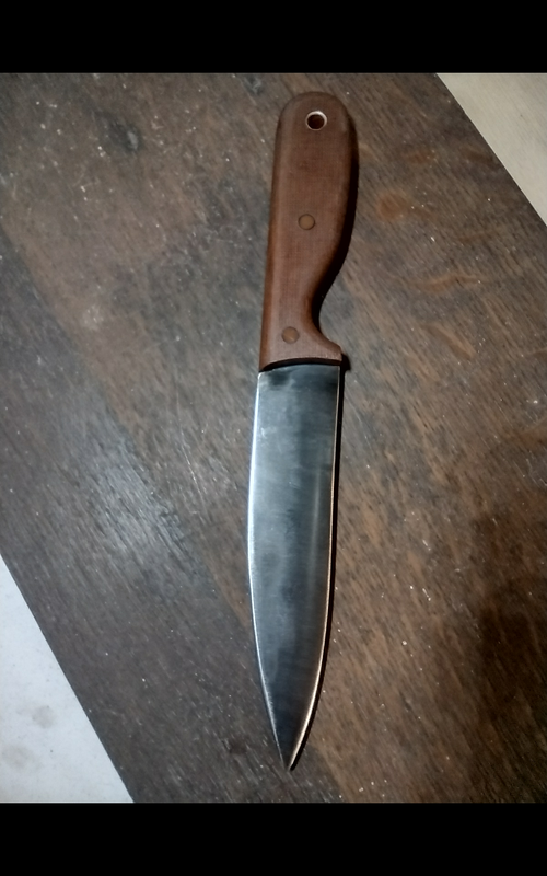

It's mid/high grade high speed steel (M2 likely) from lowly hacksaw blades.
I've been on a kick lately, and made about a dozen of these in various configurations..... I really Love them, they out cut/perform most everything. ;)
Other than being incredibly difficult to grind, I wonder why more makers aren't making knives with them.
interesting, you say they are hard to grind since they were hacksaw blades, so I imagine very hard, how are they to sharpen them? We’re you able to anneal them first to bring the hardness down?
Some of the basic 8cr13mov in my AG Russell Cowboy is a good daily user, does the job. and my Manly Wasp in Sandvik does a good job too. My Old Hickory 1075 folder is doing well too and has gotten good pocket time, and I go back to my Buck 112 Slim just because I love the shape and it cuts. So if a steel does a job and the user is happy with it, a good bargain on a decent knife, go for it. The gaucho knife is made by Cahoon and in 8670.A2968134-5F71-4AF4-90D8-59F0D26E0F65.jpeg10FC247C-6CF3-4C05-9543-EE5090CEB818.jpeg81C5C795-0057-4875-818F-3C100C627354.jpeg
Very Very Hard. I think the brand of blades were tested as 66-67HRC by another maker here, I'd have to dig through emails to be sure? But VERY hard.
I don't currently have diamond plates/stones.
I am using ceramic belts (50 grit) to profile, bevel, put edges on them.
Then I like to clean up the burrs with three different grades of @Baryonyx bench stones. Manticore, American Mutt, Artic Fox......I think mostly, the bench stones are made out of silicon carbide? They are pretty inexpensive..... and the I do testing with cutting Lots of cardboard. They really are Amazing at cutting!!!
*No annealing.
That would take away their Magic. Haha.
Plus, that would have to be like 2000 degrees about.
It's not a conventional knife blade heat treatment. They are also surprisingly durable and flexible too.
Yes, I have broke a few in vices, dropping one on concrete the tip flew off, and shattering two while drilling.
But other than that...... I'm Super impressed.
I can't stop playing with them. They blow Alot of knives out of the water!
