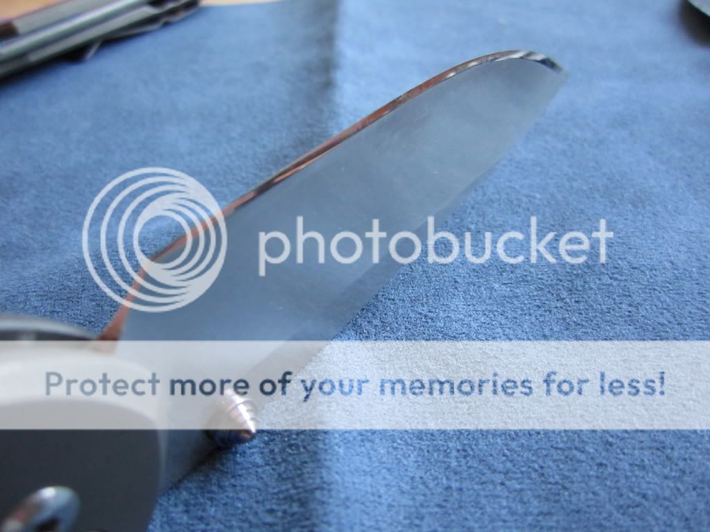

I'll start with some spirograph on bark ... Had a rough day yesterday so I thought "what the hell" and unleashed the Wicked Edge on this beauty ...

I was actually very conservative ... only touched up the very edge with the diamonds at 24 degrees to remove some micro nicks. Then went down to 20 with strops only, trying to follow the factory edge. It is almost impossible to mess it up this way. It turned out very well.
On the second one I was a lot more aggressive and reprofiled at 20/19/18 and 17 as I was unhappy with the factory bevels ... blame my OCD ... It turned out real nice as well but the chances of screwing up are much higher, especially towards the tip. I should also mention that I have done a lot of cheap blades and my kitchen knives very often before I gathered the nerve to do this ...
I was actually very conservative ... only touched up the very edge with the diamonds at 24 degrees to remove some micro nicks. Then went down to 20 with strops only, trying to follow the factory edge. It is almost impossible to mess it up this way. It turned out very well ... I'll post some better pictures later.
BRAVO!! Love it! I have always thought a beautiful blade like the one pictured above with an ok factory edge looks better with a screaming sharp mirror edge. I think the mirror edge adds value and looks to the knife. However I can understand if collectors are rolling in their graves right now..if you have to skills do it in my jaded opinion. Just please make sure you do have the skills:D

I can see a mirror there ... very nice! Love that bark by the way!
