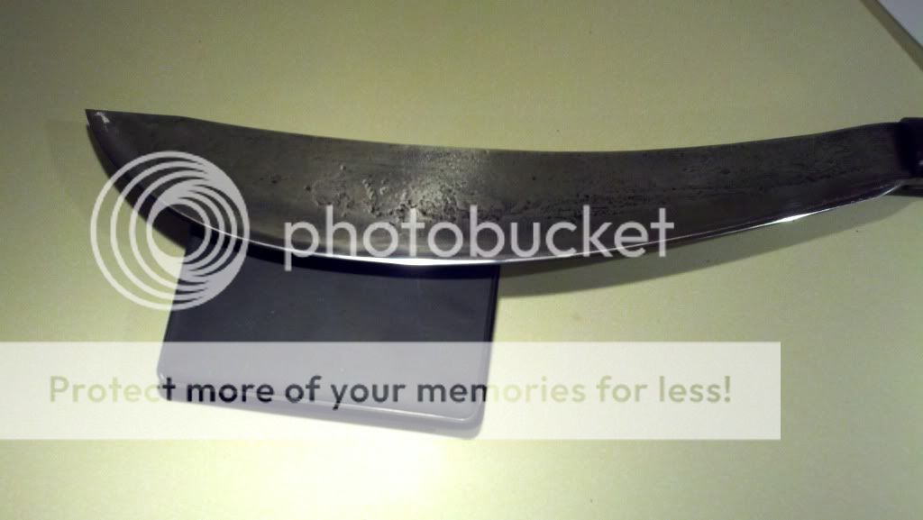

Using the Edge Pro, I took the stock edge on this BM 581 from mild to wild by doing a complete reprofile and polish:
This Spydie TUFF came to me sharpened, I gave it the paper wheel buff treatment to reallly make it "pop"...
I gotta get a pick of my Strider SNG, I just finished it on the EP system...
Why work on any blade when one can experiment on a perfectly irreplaceable blade ... To tell the truth I wasn't happy with the original bevel. A couple issues needed to be corrected. The results are perfection!
Reprofiled amd polished my Wilson Combat Zaan. Made it a slicer with just one single 30 degree inclusive bevel on the wicked edge. One of the sharpest knives i own. My poor photo taken with my iPhone:
The factory edge on my small Sebenza Insingo and Mnandi sucked so both went through a reprofile on my EP. Not to a mirror finish since they are both users. Took them down to ~18 degrees per side and now they touch up great at 20 degrees per side on my sharpmaker. The micro bevel keeps the edge from rolling and still holds it for a decent time.
