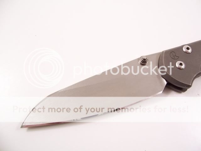

It's hard to get a good pic on my cell indoors but it's a nice polish. Stupid sharp. Though I am worried it's too shallow an angle, even for S30V.
And no, that's not a wire edge just a bad pic. Weird looks so much better in real life

What deg bevels you running on that?

It is likely I've taken my Umnumzaan (in S30V) to a lower angle than what appears to be on your Sebenza. It's been totally fine so far. I'm sure that the edge will hold up fine.
One of the great things about low angle bevels is that they are much much easier to sharpen when the start to dull--provided they are properly apexed.
I have no clue. Whatever angle my hand tells me feels right. I do all my edges free hand. Waterstones, spyderco benchstones, and lots of stropping.
I hope you are right. I did get some micro chipping/rolling while using it during my move. It didn't like super tight heavy duty black zip ties.
Throw a slightly higher angle microbevel on it and that should fix any microchipping/rolling issues. I cut a few slivers of metal off of a pair of tongs with my Umnumzaan to prove a point about differences in metal hardness (and how even a much thinner piece of steel can cut a thicker piece) and didn't end up with any more than a big roll (which was an easy fix) and one small chip.
I've thought about it but micro bevels... Meh. I've contemplated it. Never been a fan of them.
