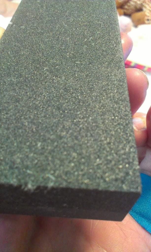

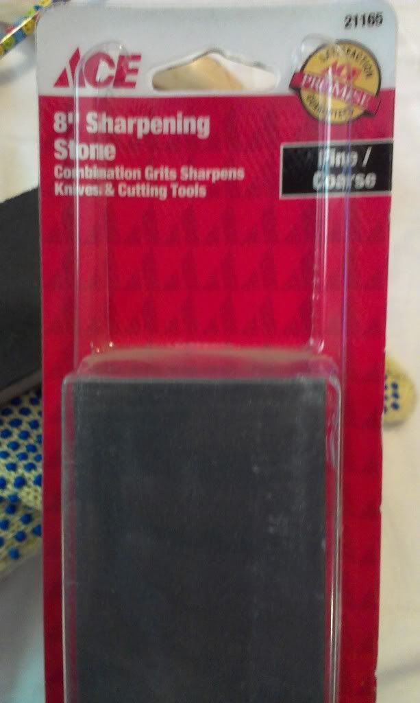

It's just a $13 Ace hardware stone. Im not sure who actually makes it. I was kind of on the fence about getting it because the grit composition and even material are unlisted on the packaging.

HH and David, would it help at all for me to share some pics?
The reason why I thought it was sic was because I had just looked at a sic stone at True Value and it looked the same, dark grey and almost black front/back. I looked up the Ace stone on their website and it looks the same as mine (packaging is completely different though) and it says alox.
I'm so confused! :D
The coarse side looks a little sparkly in bright light.
Also it's made in the USA if that helps with anything.
I'm so confused! :D
I'm not sure if a pic would help much - maybe...
I saw that ACE had a 6" stone listed as AlumOx and none listed as SiC, but having the two of them side by side made it easy to see the difference. When I tried to find out what they carried, all I could get was the identical description of stones with several price points. Why different pricing and different product numbers if they're the same item? (21160 / 21163). 21160 looks a lot lighter in color. Sadly, the larger outfits don't seem to care much about accurate product descriptions for sub 10.00 sharpening stones - even Norton had to be given a head's up...
To me it looks like AlumOx. AHHHhh - go ahead and use it! You likely won't notice the difference on most steels, and in general ALumOx can be milked for a slightly finer edge than a SIC stone of comparable grit rating anyway. It will be a touch slower but nothing crazy.
Also, its very difficult to say for sure by looking with the unaided eye. As mentioned there is a bewildering array of binders and abrasive qualities that could throw one off when it comes to vitreous stones.
