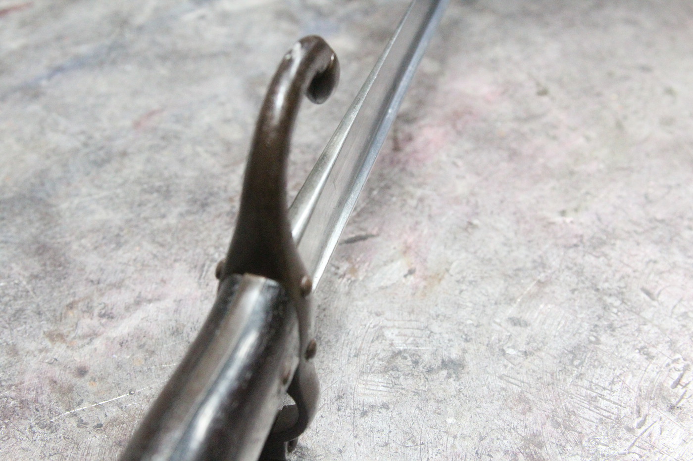

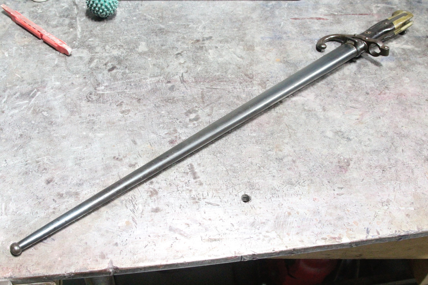

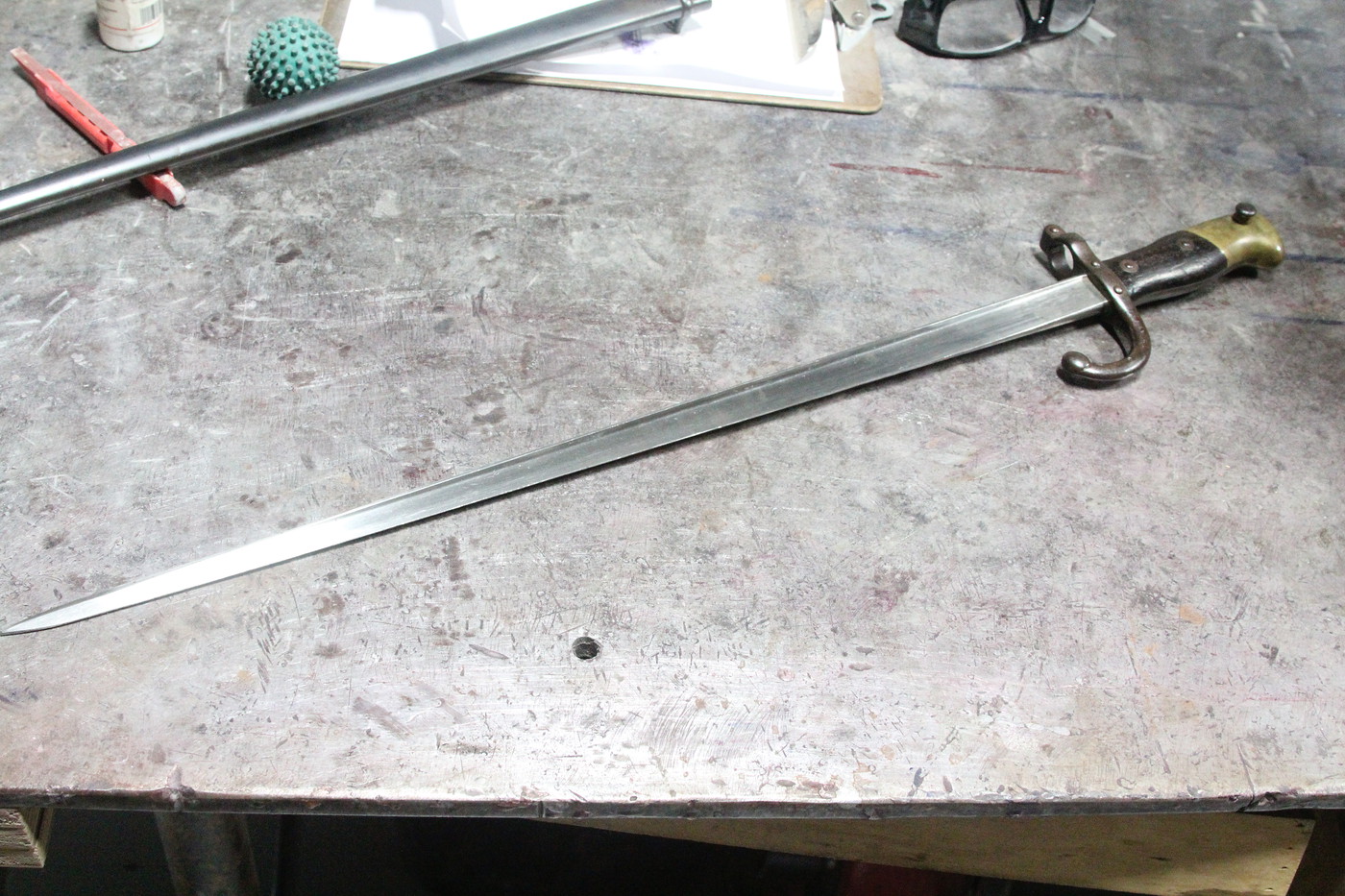

Andy wanted me to post some pics of his bayonet. There is a bit of a learning curve to taking "good" pics of schwords. Im on the uphill climb, hopefully.
I'm really looking forward to seeing what you create Andy! Such a cool project!

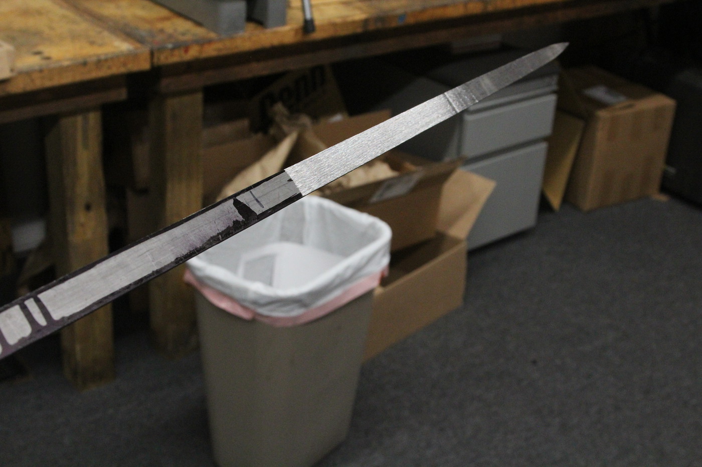

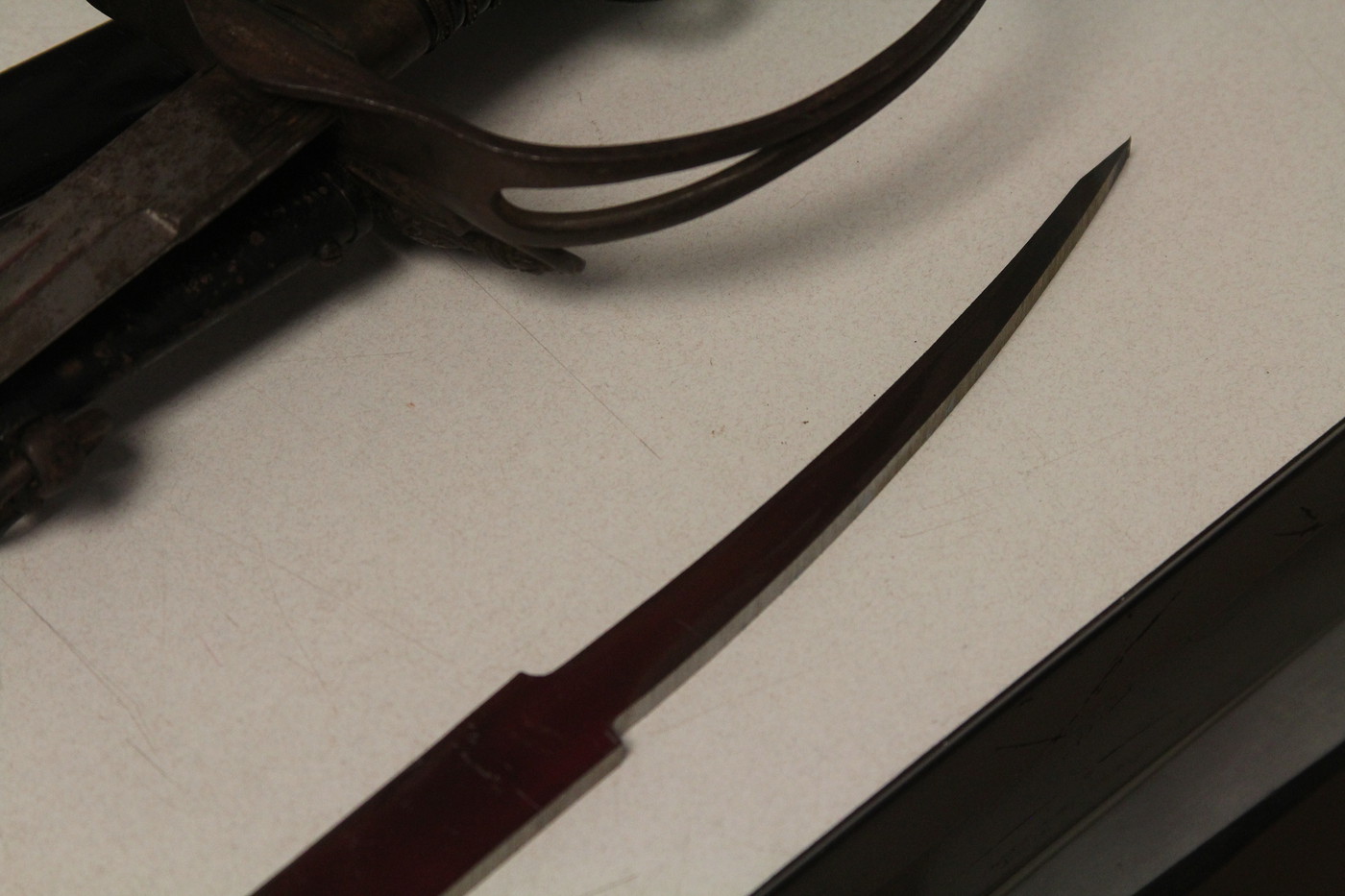

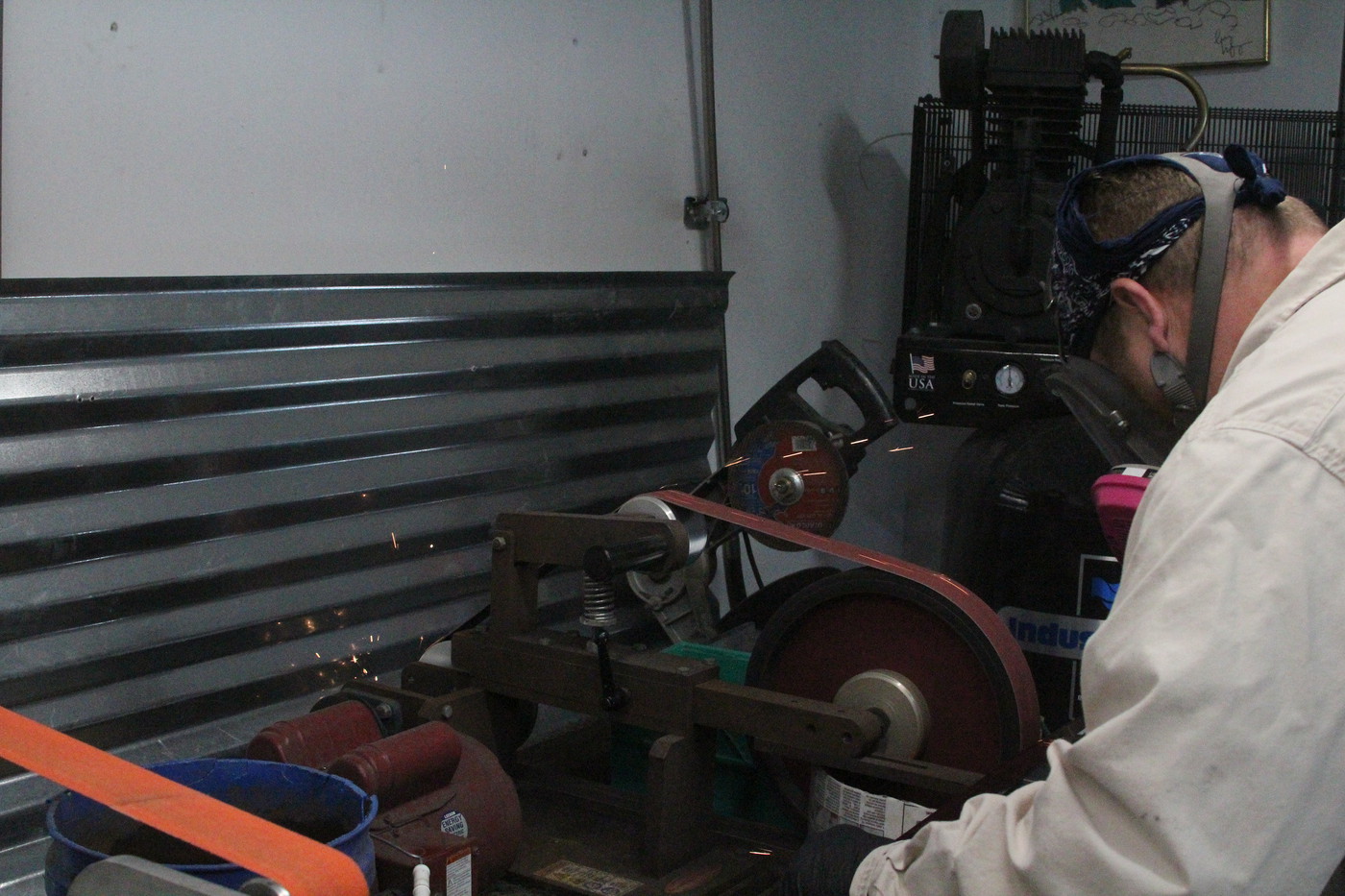

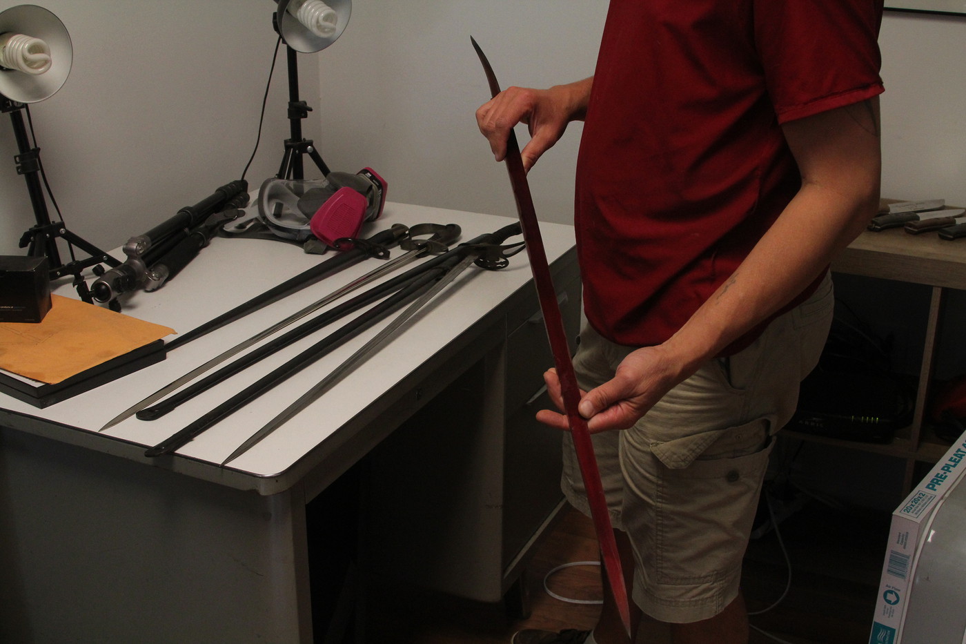

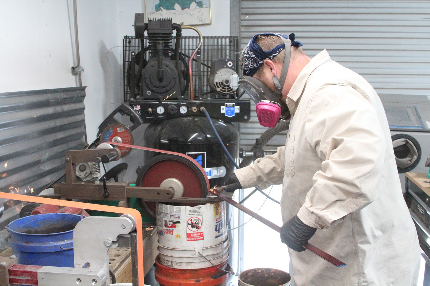

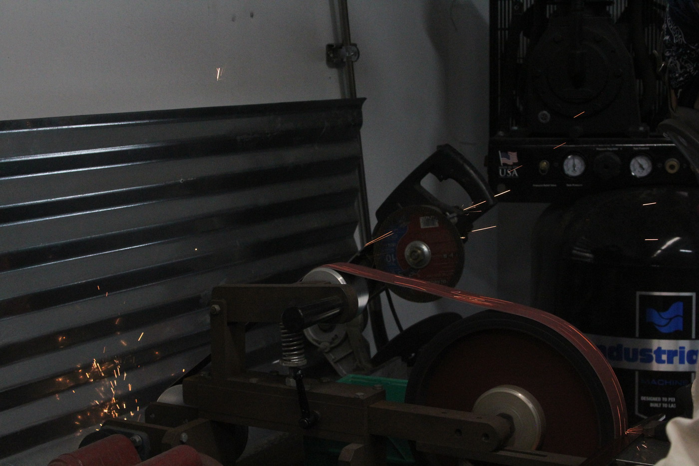

While Andy is grinding this week's knives John started to profile out the first sword
she's SPARKY...right in the FACE

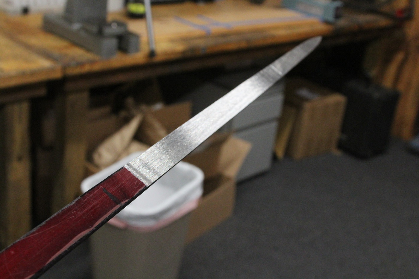

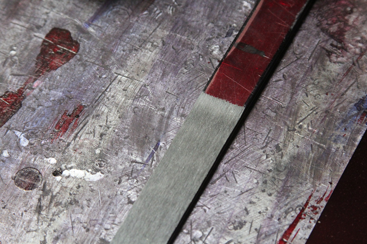

OK. I've spent a couple of Saturdays on this first sword. What I have now is a bade that is ready for HT and my first guard pretty far along. The bladework is totaly different than making knives. There is a distal taper and a fuller that are both tricky to do and kinda compound the difficulty of one another. I think I've figured out a method I like and last weekend I roughed in the fuller. Today I cleaned up the fuller and started the blade grinding which is actually quite simple. This first blade is going to get destruction tested and will likely not even keep its handle. This will give me a couple of chances to make tweaks and changes to the handle, which I will need. Once again, a sword handle is totaly different and I've had trouble designing anything that looks halfway decent.

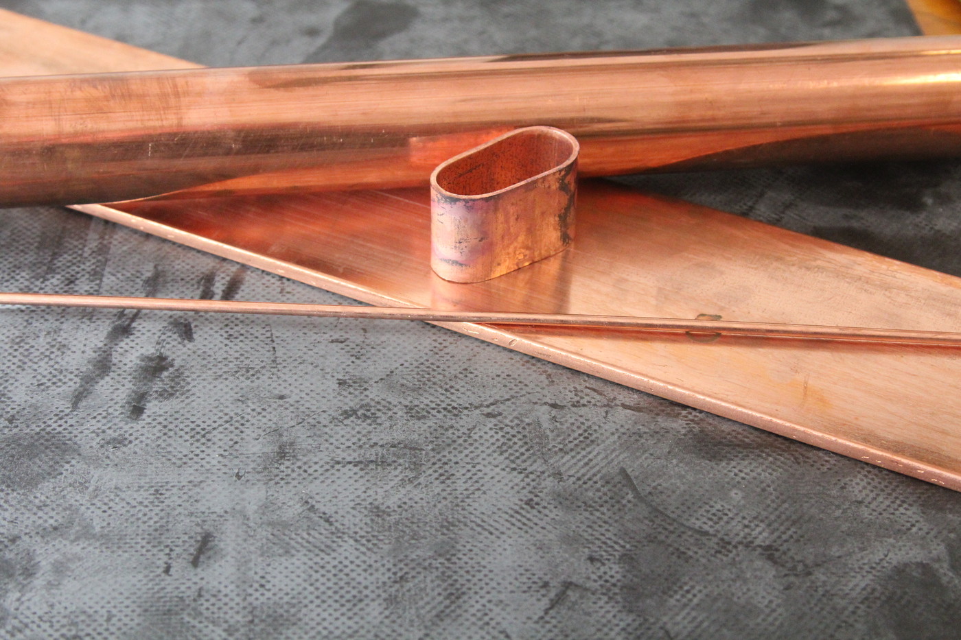

This next pic shows the copper cutout and the micarta pattern. And a coupe of experiments for the pommel.
