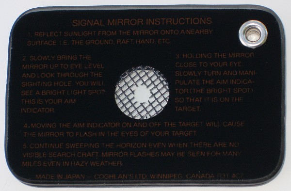

What is the purpose of the mesh in the sighting hole? Is that feature an advantage over the County Comm model with crosshair?
Lots of good info there. Thanks. After reading, is it safe to say that a signal mirror with a "real" mesh aimer would be better than a crosshair? :confused:

I've got the county comm mirror pictured above, and for the life of me I can't get the "fire ball" to appear for aiming. I'm no expert at it though. I'll have to take out the wife's AMK one and see how it compares sometime. I'm pretty sure that aiming can still be achieved without the "fireball" by reflecting the light onto your hand and using that to aim. But isn't the point of a dedicated signal mirror that it's easier to aim and use under times of stress?

I've only played with my 2 County Comm mirrors a couple of times but I have not gotten a fireball. Nothing definitive, just took it out to the Green Belt and tried it out for a minute or 2. No problems with other mirrors with the mesh.
According to the link that Walkabout referred me to, it sounds like it's the glass beads on the mesh that creates the fireball. I'm thinking there's no fireball with the County Comm crosshair sight.
"A common example of retro-reflectivity would be road signs which are illuminated back at you when your car's headlights light them up, regardless if you are directly in front or they are overhead or approached at an angle. In a somewhat unintuitive manner, the glass beads of the retro-reflective signal mirror (mesh) aimers utilize this capability to create a false image of the sun where the mirror will reflect light towards. This is the fireball you see and aim with."
