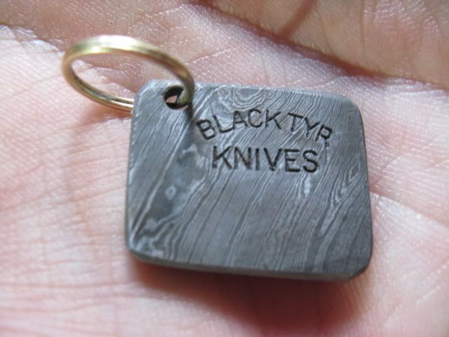

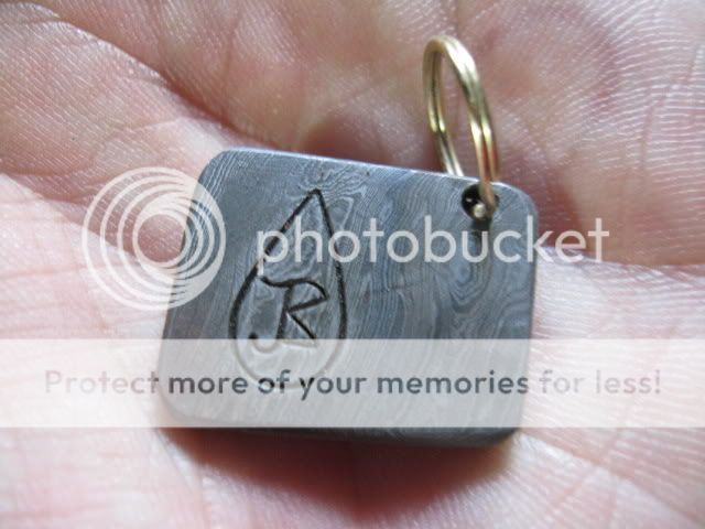

This whole thing goes way, way back to Japanese sword and knifemaking, where the maker's signature was always placed so it faced outward from the wearer's body. Therefore, a sword or knife intended to be carried on the right side would be marked on what we'd now call the reverse; one intended to be carried on the left would be marked on the obverse.
As it stands right now, the custom in this country is to mark the ricasso or top of the blade near the spine on the obverse. However, it's only a custom. As has been stated previously, there are no rules. As proof of that, I give you this:
picture.php
Never knew there was a rule...ha....just always marked on the right side
To further complicate things I have chosen to have 2 stamps and am deciding on what side to put each mark. So far most have the name on left and the symbol on the right, but I am playing with the order- and may reverse it on my personal knives so that the symbol is on the left.
