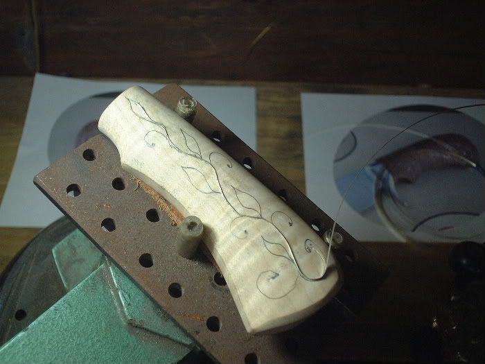

I wanted to take pictures of this process anyway, so there's no reason to not share them with ya'll.
You will see some pictures in the background on a few of these here. It's a photo of a knife that my customer wanted to emulate on his knife.
This is a pattern I call "Wandering Vine" and is one I have used many times.
Here's a little step-by-step:

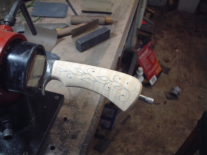

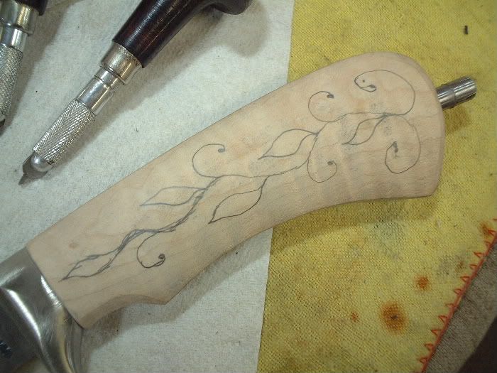

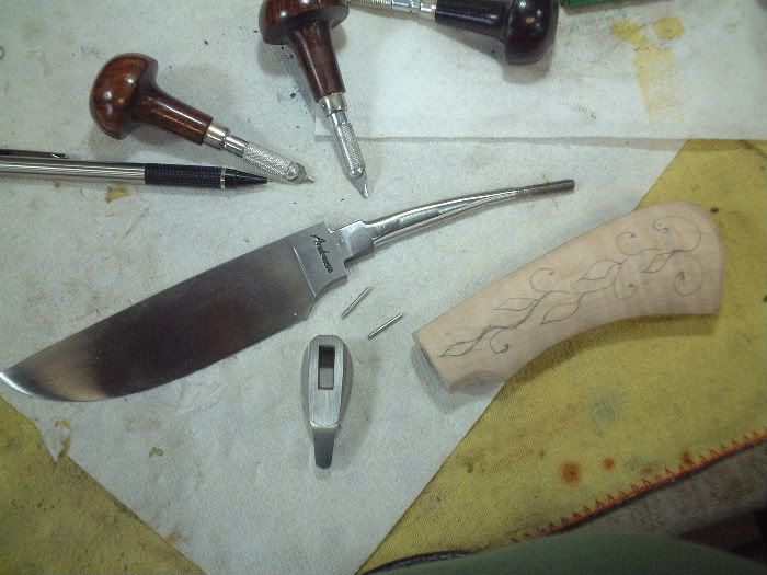

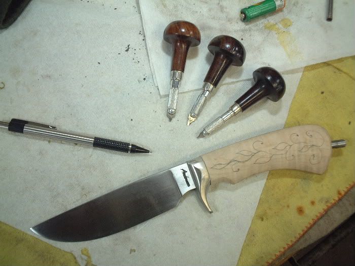

This semi-finished knife with the layout and some of the in-letting tools involved:
A little closer shot of the layout:
Gotta just LOOOOOOOVE the take-dwon knife when it comes to stuff like this:

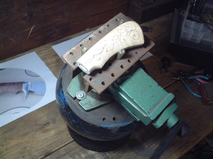

The handle in the bowling ball vise - (thank you, Mr. Keeslar!)

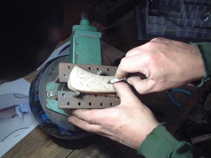

It's still early and I'm not ready to sit down - yet:
A little close-up of the process:

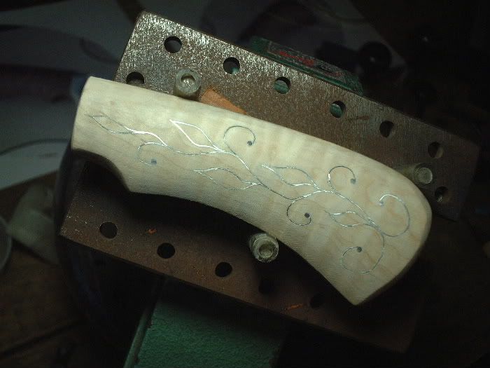

The main "vine" nearing completion:

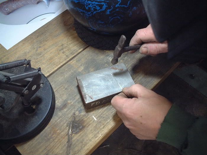

When I do a "branch" or wherever two "things" come together, I use a small hammer and beat the silver wire down veeeeeeeeeeeeeeeeery thin so it blends in seamlessly:

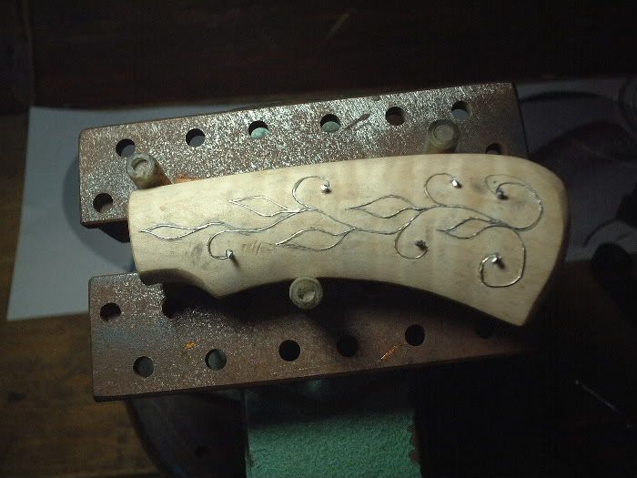

Here is the completed inlaying done, along with little seed "pods" at the ends of the branches:

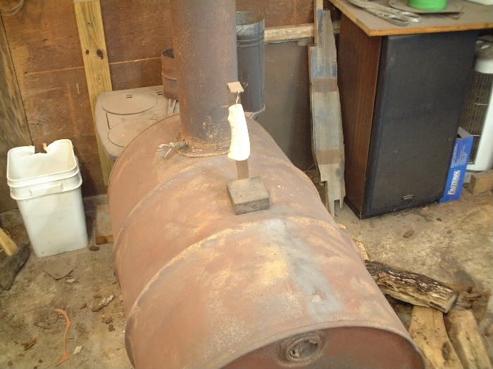

Now, I saturate the handle material with water so as to swell up the crushed wood grain and make it fill in the voids and "grab" the silver wire to hold it in place.
Prior to putting the wire in, it is drawn through 220 sand paper to put lengthwise scratches in the sides to help hold it in when the wood is swelled.
If it was summer time, I would place the handle out in the sun to dry, or maybe in my kitchen gas stove, since it always holds about 120 degrees from the pilot light, but since it's the middle of winter, I'll set it atop the wood burner and head to the gas station for a cup of coffee and a cookie!
Came back, clamped up the handle and filed the excess metals off.

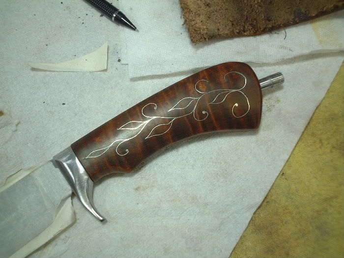

The completed handle ready for some COLOR!!
Amazing what a little color can do to some nice curly maple!
Now I'll finish off the guard and put a good soaking coat of gun stock finish on the handle to dry over night.
0000 steel wool in the morning and then another coat of gun stock finish.
Finished picture probably on Friday.
