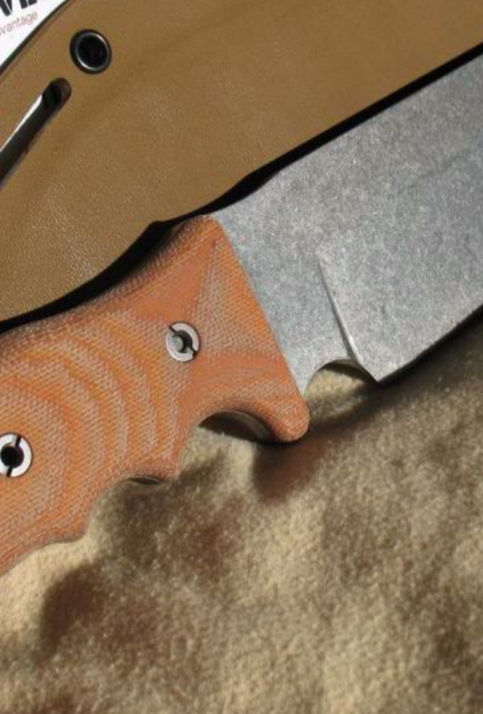

In all seriousness, has anyone modified their GSO and filed down the jimping? I might try that once mine arrive...
A less drastic first step might be to use some plastic handle coating compound to fill in the jimping.
If that doesn't hold up there is always epoxy.
As the very last alternative you could try an angle grinder. :eek:

I hadn't got around to it but tonight will 'stone' the sides of my 5.1's jimping - no way am I going to file away the jimps themselves, too much work for a potentially ugly result, but it shouldn't take much effort to round over the edges enough to make it a bit more comfortable :thumbup: You should be able to do this with just about any hone - use something very coarse for the initial work then smooth out to the desired grit. I'll report back tomorrow.
That's a thought! :thumbup: I saw a youtube vid where a guy epoxy'd the grooves on the scales of a Benchmade Bone Collector to smooth-out the handle... Wouldn't take much to fill in jimping-gaps.

Alright, I didn't have time last night so i did the job this morning just now, here are some quick cell-phone pics:
My GSO-5.1 and a couple of hardware-store hones:
Here is the smaller one - coarse/fine 1"x3" SiC or AlOx hone that cost ~$1 at the local hardware store
This is what the untouched side of the jimping looks like
And after rubbing the coarse-side of that little stone back and forth and rounding over the other side, <60 seconds later
One could use this same stone or another to round the edges between the jimping if desired (a round ceramic rod would work perfect for that), but this gives you an idea of what can be done quickly/easily/cheaply to improve your comfort. Just rub it to the desired grit/polish and go :)
Looks good Chiral! That is the age old dilemma, tumbled and not sharp or not tumbled and too sharp. We are trying to be somewhere in the middle with this finish, but the jimping can still be a bit sharp depending on what you're used to. I'm sure folks will be happy to see that there is an easy option out there! (Not easy enough for us to start offering it in house so please don't ask :))
