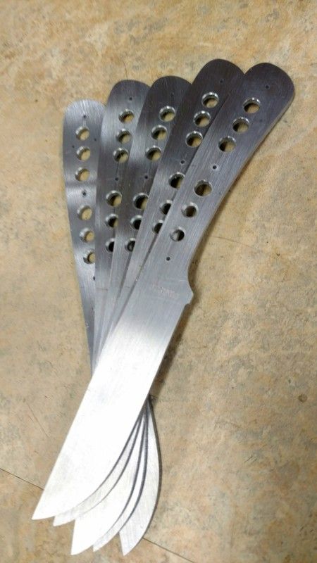

As you can see, I'm not that good at coming up with thread titles. Here's a batch of a simple design that I'll be working on.
Can't have a WIP without a picture of fanned out blanks. I think that's mandatory.
As always, everyone is welcome to comment.
Come out of the shadows lurkers, we don't bite. Well, Mack does but he's had his shots:D
These are 1/8" O1, 7 3/4" long with a 3 3/8" cutting edge.
Some 1/4", and 3/16", holes to lighten things up and help the epoxy bridge through. I'm gonna go with 1/16" peened pins. Each will have a different handle material, it's not set in stone, but maybe some Blackwood, Mesquite, Chechen, Bocote, Walnut.... We shall see.
I use a Milwaukee portaband saw mounted vertical in a Swag table, and square them up on the grinder toolrest. I'll try to get some pictures of my setup posted.
So does I, put a piece of aluminum on it for a table.
I used to use a piece of poly cutting board for a table and that worked good. It would be nice to have a big metal band saw, but they sure ain't cheap.
No there not, what's nice about my set up is I can take it off the bracket I made and use it as a portable.
