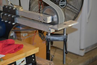

Personally, I'd consider something like this. It doesn't need a second tool arm slot, and it always solid to the wheel.
Yes, it's a 2" tube, 1/4" wall, with a 1.5" x 1/4" bar holding the rest.

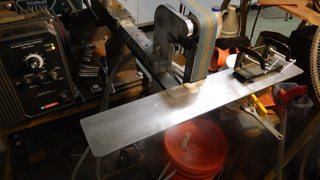

Randydb and Valknut, I wanted a faster, more adjustable rest for at least two years before I finally took my KMG apart and made a second slot...days later I had the adjustable rest completed and have never regretted it. What a pleasure my grinder is to use now. You guys wont be sorry for taking the time to have a second slot. First photo is the old nonadjustable rest . Second photo is adjustable rest attached to tool arm which is complicated and time consuming to use and the third photo is the new adjustable tool rest that is fast to adjust with all my attachments. Larry

That third rest. Can you adjust the angle of the third rest? If so can you show a picture of how that works?
