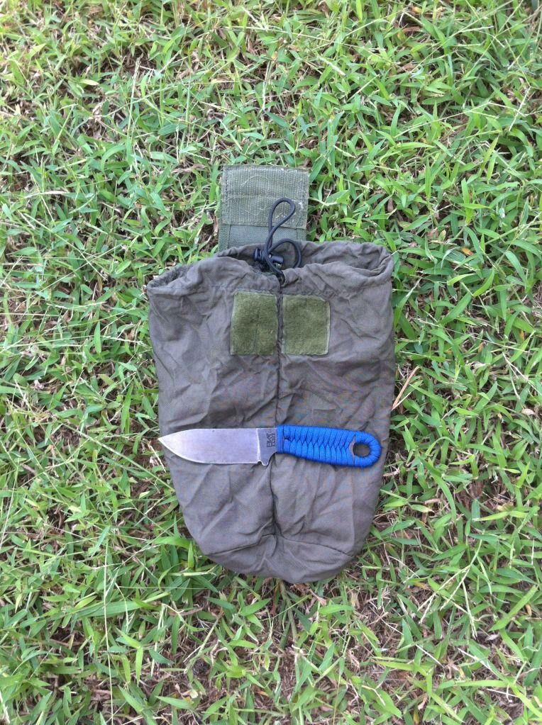

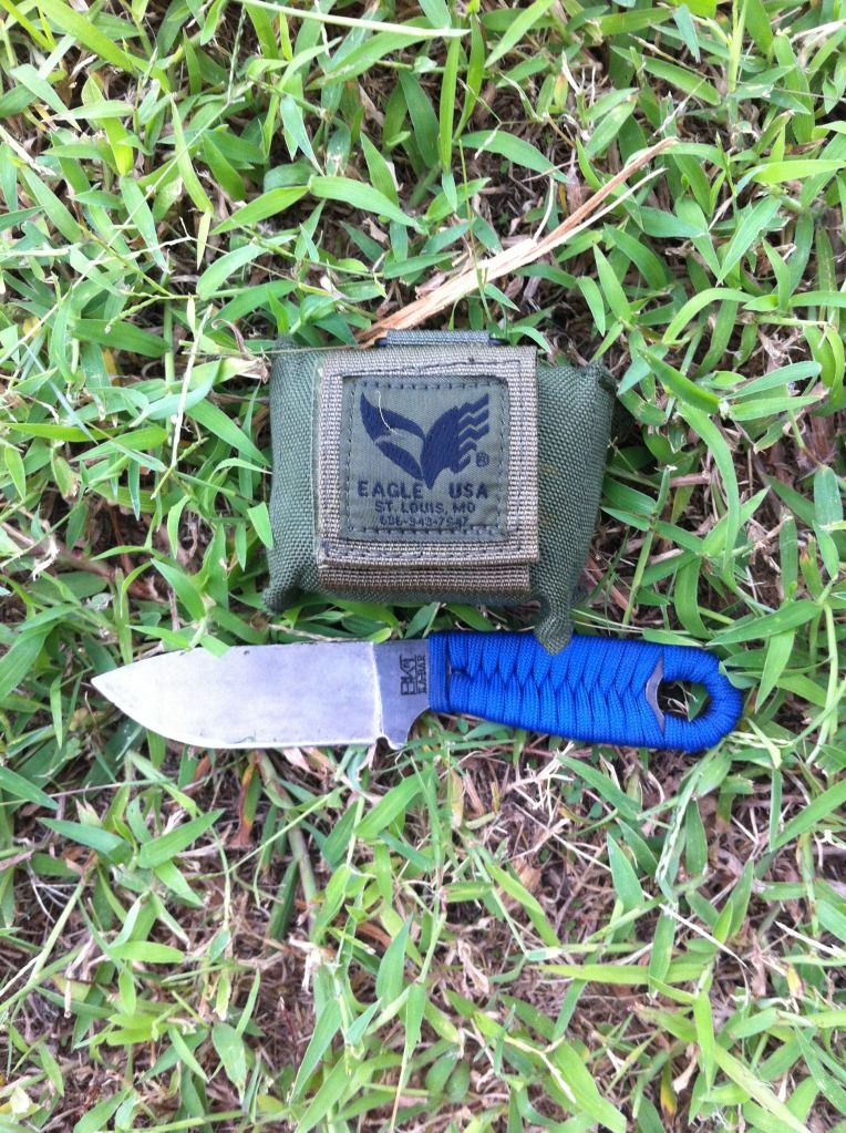

Got another awesome piece of gear today, an eagle industries dump pouch
Also going to a gun show tomorrow so I'll see if they have anything cool there
