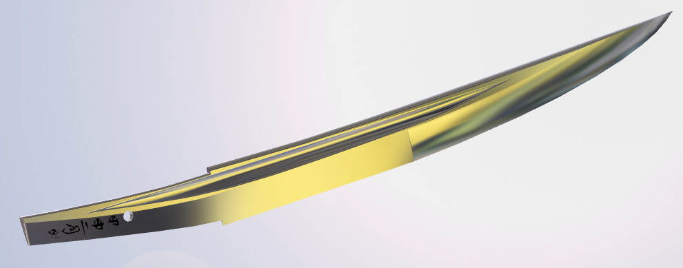

Is the blade bevel all one smooth surface from machi to kissaki? I don't see the
yokote at the osoraku point.
The yokote on an osoraku tsukuri blade usually shows in the polishing by having a different finish on each side. This is most easily done by polishing the whole blade and then taping a thin slat or wood, or putting a piece of tape at the yokote, and polishing the kissaki in a different finish ... usually a matte or frosty look. It can also be done on a fully polished blade like yours by painting the ha and ji with a masking compound and etching the kissaki with dilute acid to get a frosty blade in that area.

Well, I have struggled a couple days with bringing out the hamon.
I started with wiping on fairly concentrated FC and the reaction seemed too fast and aggressive.
I repolished it and started 15 minute baths in white vinegar after reading Willie71 in "The Hamon Thread".
This was working, and while polishing between each soak, the piece was taking on a beautiful very slight gray appearance, but glossy.
It seemed that the vinegar was not etching as well after the first couple soaks, so I added a small fraction of my FC solution.
This was working well and was still controlled.
I thought I was getting more efficient with the polishing. I wrapped an EDM stone in the 3M paper and it was working well until a SET BACK!
The stone made its way a tiny bit through the cloth. I didn't hear or see anything different, but close inspection shows some very light scratches.
The first image is direct sunlight and exaggerates the scratches. The second one is indoors and shows the hamon as darker.
In any case, I'm going to drop back to 600 (hopefully not lower) grit and redo the polish until the scratches are gone.
One option based on a suggestion from Stacy is at the end, to try to achieve a different, brushed look on the part indicated in blue (like Stacy's first image above).
I'm not sure about that yet, but I'm going back to sanding and cycles of bringing out the hamon (hopefully without scratching it this time)
It is wiser to use a bar of hard wood, bronze, or aluminum as a backing block when sanding. On some sanding tasks in togi, I use a block of lignum vitae with a very hard leather surface on it.
