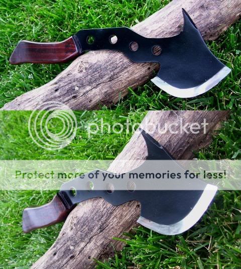

SK1 Hatchet for Sale
Hope you like.
Shop Details:
5160 Steel Head was cut out and Normalized @ 1500 degrees until non magnetic, three times, to remove stresses and align crystals. Heat Hardened until it became nonmagnetic, then quenched in 125 degree quality oil. Tempered it to a straw hardness @ 425 degrees for 1 hour, letting it air cool and repeating once more. Steel head was file tested and is shown to be very hard.
Measurements:
Total Length = 14 ½ ”
Edge Length= 4 ¼ ”
Head Width = 4 ¾ ”
Head Thickness = ¼ “
Handle Length = 5 7/8 ”
Handle Width = 7/8 “
Handle: Cherry, 4 hiddin pins
Weight = 1 ¼ Lbs
Lowered to $89 plus $16 shipping fee, if shipped in the US. Includes belt holster. You can send through Paypal to ScorpionBows@mchsi.com or mail M/O to our address (see web site for address).
Pictures below. Thanks.
