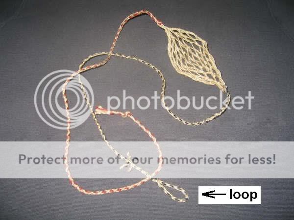

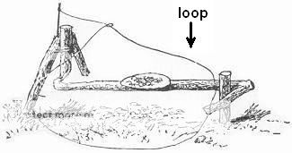

Still not convinced? How about these?
That do? There are lots more. :D
I should have also placed an arrow pointing at the fixed loop that the snare loop is sliding through.
Doc

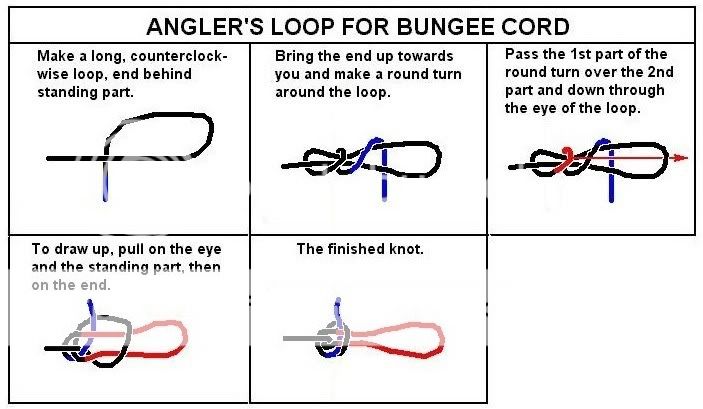

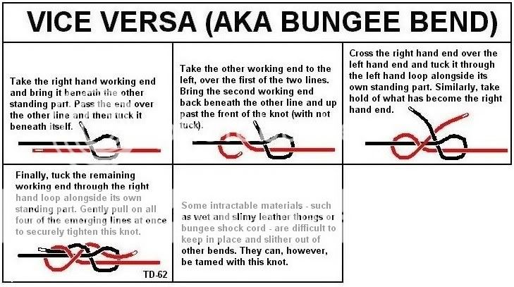

Don't say I didn't try to keep your thread alive. A couple more for you to play with. These go by different names, but I call them the Bungee Bend, and specially for you, the Bungee Loop! I call them that because they are a couple of the few knots that work for Bungee/Shock cords. If you ever go through a Canadian Tire/Home Depot/Lowes around Hamilton and see the roll of Bungee cord with a loop tied at the end, you know I was there! :D
They also work well in other material that don't take knots well, although they can also be used in jute, 550 and anything else.
Bungee Bend:
And the 'psy-ops Bungee Loop':
